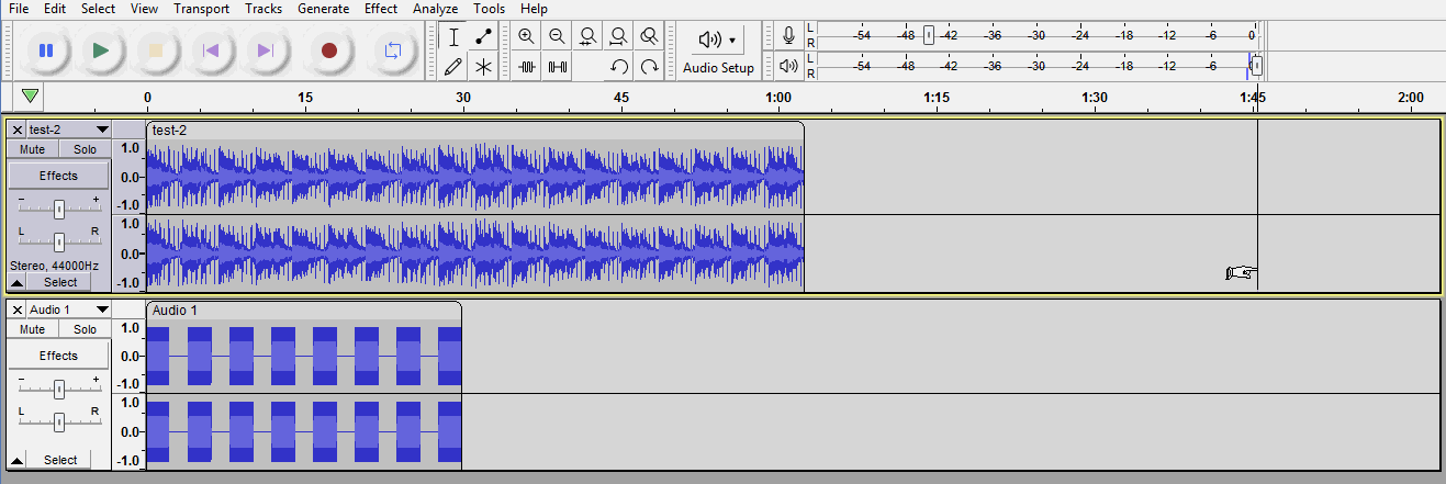

Can specify in Audacity preferences to record on a new track, (rather than than append).
https://manual.audacityteam.org/man/recording_preferences.html

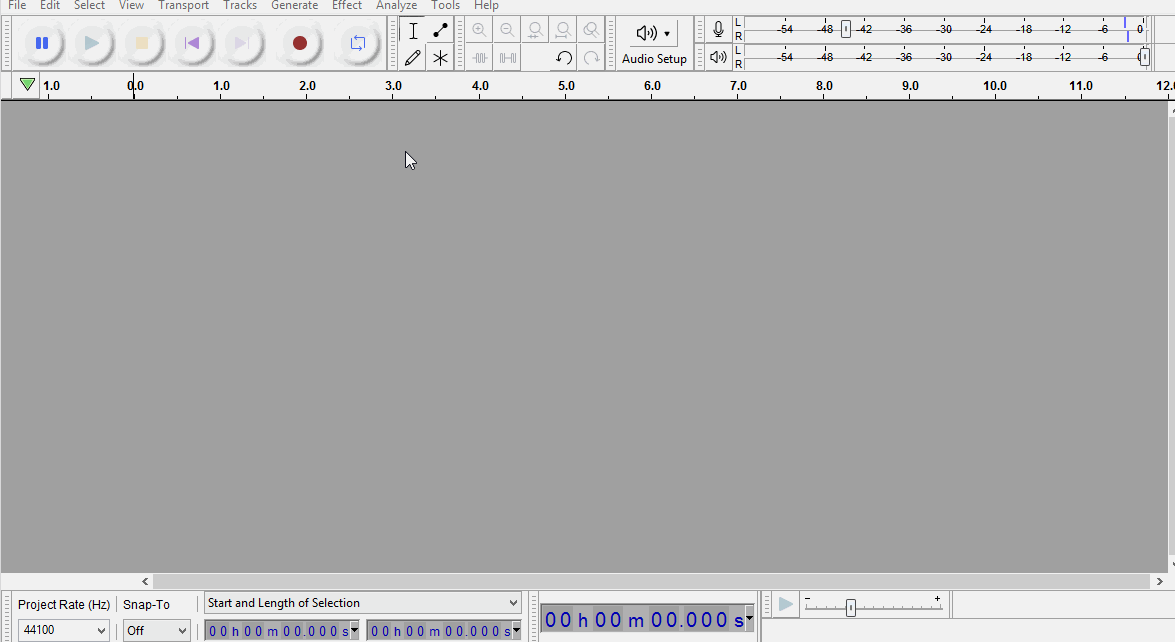

My reply showing how to insert audio is just a visual (.gif) thing: no sound.
The “X” on the far-left top-corner of each track closes (deletes) it …
Audacity Preferences: tracks, auto-fit track-height
