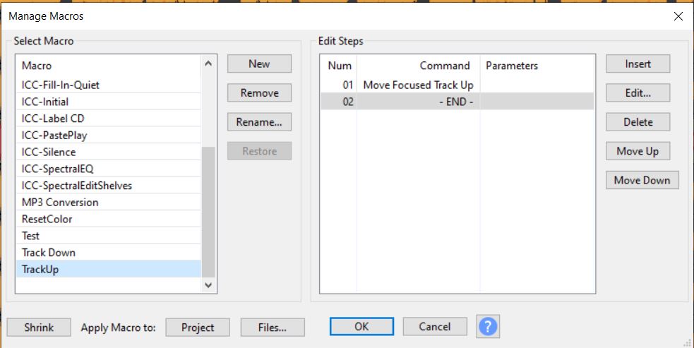

Hi Charlie,
This approach might be faster.
Create a Macro that
  • changes the color of the track you want to duplicate (so it is more noticeable)
  • duplicate the track
  • fit to height
Run the macro and you end up with the new track at the bottom, the original track and new track are a different color, and you can see all tracks fit to the screen.
Create another Macro that moves the selected track up and assign the macro a shortcut key (like Alt+9). You could also program one of your mouse buttons to to be an Alt+9 if you have a programmable mouse (I use a logitech M720 with 8 programmable buttons that can be set differently for each application running).
Click on the bottom track (anywhere) and run the second macro - the bottom track moves up. Click on the track again and run the second macro again and the track moves up again. Keep doing that till the two colored tracks are together.
You could have also have a Macro that returns the track(s) to the original color. You would select the two colored tracks and run that macro.
I think that this would be quicker than doing the drop down menu and selecting Move Track Up, … and the colored tracks help you to keep track of what’s moving where. If you had the keys on your mouse programmed to run the macros, you would just click on the track(s) and then click your mouse key - a much simpler (and quicker) motion than using two hands with the mouse AND the keyboard.
If the original track was originally closer to the top of the screen, you could have a macro like the first one above with the last command being “Move Focused Track to Top” and then you could have a another macro that moves the selected track down instead of up.
That might save quite a bit of time.
Mike
I guess I misunderstood the question - but if you were to color the track you want the new track to be below, then you wouldn’t miss it when you move the other track(s) up.

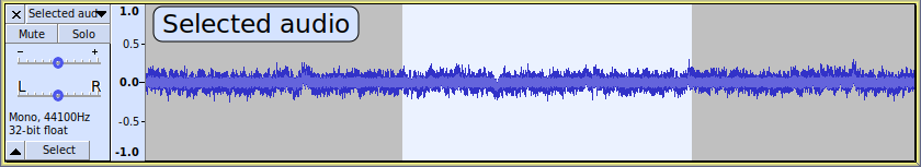

Unless you use screen reader software, the important thing is the “selection”.
There are two parts to a selection:
  1. The track or tracks
  2. The time region.
  3. When a track is selected, the panel on the left end of the track becomes highlighted.
  4. When a time region is selected, the selected region is shown in the Timeline
  5. When an audio track is selected and there is a time selection, the selected region is highlighted in the track:
    When applying an edit or an effect, it is applied to the selected audio.
    When applying “track commands” (such as mixing tracks or resampling tracks), the commands are applied to the selected tracks.
See this section that I added for the 2.4.2 Manual: https://manual.audacityteam.org/man/audacity_selection.html#focus
Peter.

Charlie and Peter,
One more try.
You could use macros to help by maybe having multiple macros each connected to a keyboard shortcut. The macro would look like the one below which puts focus on the last track and then moves it up 3 spots. You could do separate macros for moving up 1,2,3,4, …
A couple issues I came across are as follows:
  • If you have focus on the last track (which happens just after a track is created), the first execution of the macro only moves the track up one track (a bug to be reported ???), even if there are multiple move up commands in the macro. So then the macro won’t work again since executing it a second time puts focus on the last track, not the new track that has already moved up one spot. So you need to make sure that before you execute the macro that focus IS NOT on the last track.
  • Once you execute the macro, focus shifts to the first track (an unexpected shift in my opinion) and so you would need to complete the correct number of move up commands in one execution of the macro. Which means you would need to know how many tracks to move up and you would need to have enough macros to accommodate the number of move up you want to do.
Without the few minor glitches above, moving a newly created track to the proper position could be as simple as a keyboard shortcut.
Would there be a way to write an effect in Nyquist code that knows the track number you are on, knows the last track number, and can move the last track up based on the difference between the last and current track numbers? Or does Nyquist just act on a selected piece of audio?
Mike

The plug-in “trackmove.ny” moves the bottom track up to one below the track that currently has focus. Feel free to adapt the plug-in to suit your needs. If you get stuck, start a new topic on this forum: https://forum.audacityteam.org/viewforum.php?f=69
Charlie and all,
I think Steve’s last post addresses exactly what Charlie was looking for. Insert a new track, select the track you want the new track to be below, execute the Nyquist command to move the Track Here. It worked for me.
