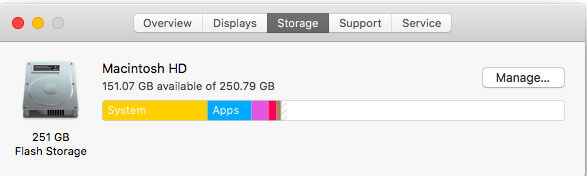

There’s a fan in the thing
We all have fans.
You can usually hear it ticking and scritching in there. I know how to make a Mac tell me what it is, but I don’t know how to do that in Windows.
It’s good to find that out because you don’t defragment SSDs. They’re really different.
