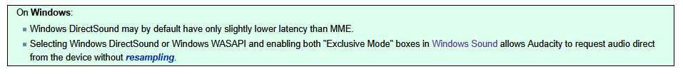

Tutorial - Selecting Your Recording Device - Audacity Manual seems to indicate this is possible:
“Selecting Windows DirectSound or Windows WASAPI and enabling both “Exclusive Mode” boxes in Windows Sound allows Audacity to request audio direct from the device without resampling.”

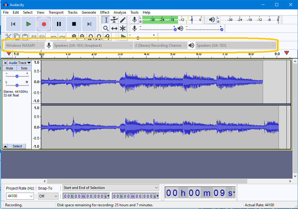

When I use loopback on my W10 and W11 PCs I have these settings - this is my W10 with Audacity 3.7.3
And that works fine for me - the track that you see a part of is a recording I just made from a website playing music on my computer.

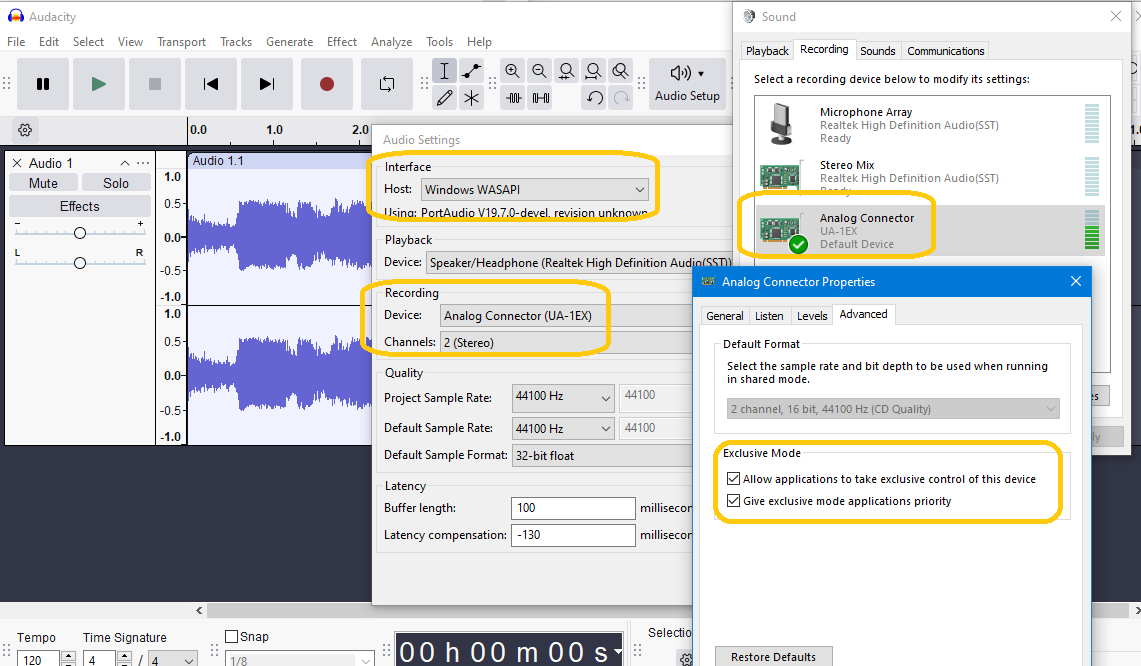

The Windows 10 Sound Settings (as per your other screenshot) for the Topping DAC have both Exclusive mode boxes ticked.
This works fine for recording in Audacity if the player (Foobar app on the computer) has the “Topping DAC” selected as output device.
If the “Topping DAC Exclusive” output device is chosen in Foobar I get the Invalid Device message from Audacity when trying to record. Which is kind of what I would expect from what I’d read about how WASAPI Exclusive mode works, but that Audacity Tutorial seems to imply otherwise.

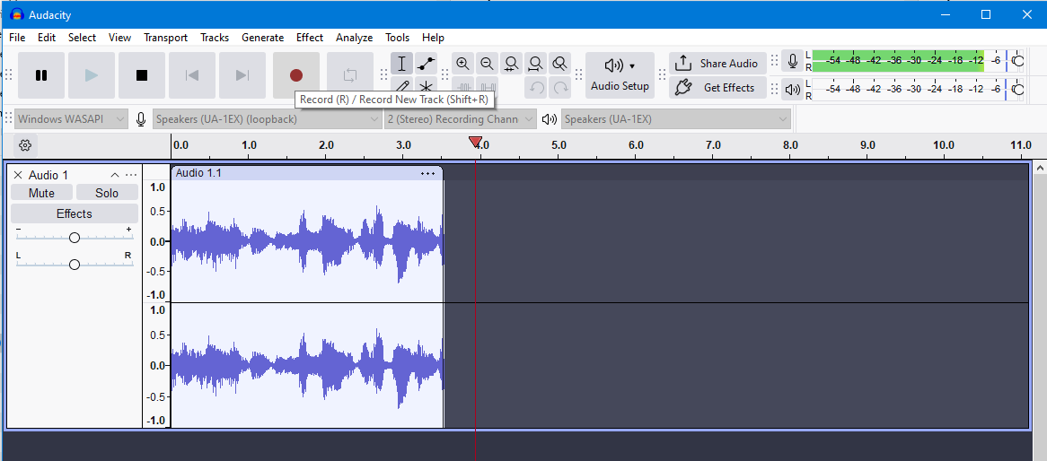

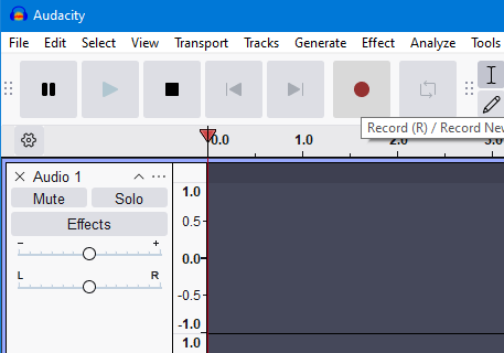

Indeed, and usually I am only using the ADC side of it to connect analog devices to my PC/Audacity - but in the interests of experimentation I attempted to use loopback on the Edirol (to be honest I never noticed before that that was a possible available option) so I used these settings:
But when I try to record, either with the exclusive settings on or off, all that happens is that Audacity goes into record mode with the red recording cursor stuck at T=0 and with no recording taking place. I don’t get the “device not available” dialog that you get.

Hi - yes that’s how I understood WASAPI exclusive mode worked too. It was just that comment in the Audacity tutorial that seemed to imply it might work a bit differently.
It would be great if it was possible to loopback record from a device in exclusive mode, so that all the Windows processing was avoided. However that doesn’t seem to be possible currently.
