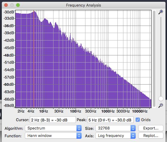

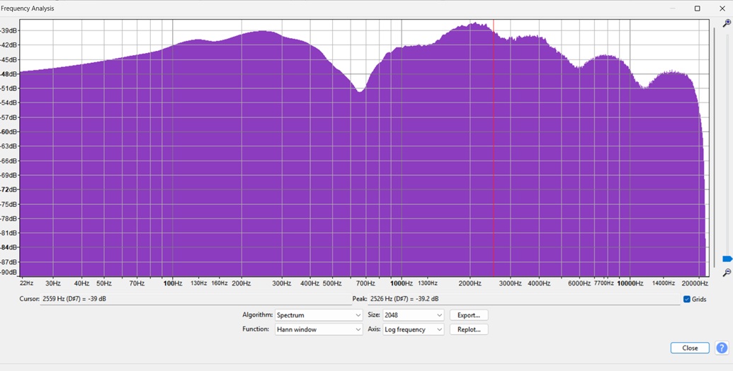

Attached is a screenshot of Audacity Spectrum of the recording of white noise I made in Audacity:
As you can see, there is a dip between 600 and 700Hz that looks suspiciously like EQ being applied somewhere, and I don’t know how or where to turn it off! Anyone in the audio field knows that white noise should measure flat, with no major rises or dips in it.

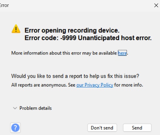

Disabling any APO(audio processing objs) results in the attached error image from Audacity. (enabling the apo/s allows Audacity to record)

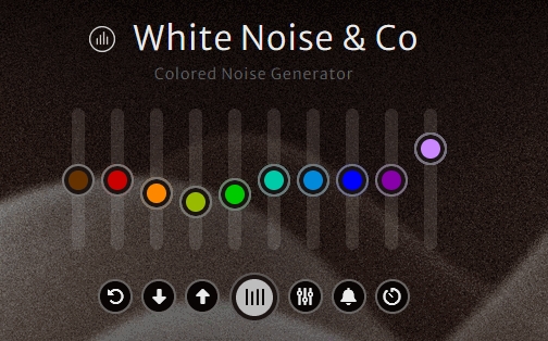

Actually, I did test recordings in Audacity of the pink and white noise from this site and others:
‘The Ultimate White Noise Player’
And the Audacity spectro of all recordings had that same dip centered between 600-700Hz.

If I remove or disable the Realtek HD, Audacity returns the error I posted a screen shot of.
You are intentionally muffling the spectrum display. Increase the “Size” setting and the sharpness and accuracy of the display lumps will increase.

We’ll see what it looks like when you bump up the Size number.
That could be what it looks like when you play the noise flat into a speaker and then record a microphone in an echoy room.

I played with the sizes already.
What you see is what I got.
Those minor dips in the HF pale in comparison to the elephant in the 600-700Hz region.

I know a lot more about that site than you guys. I used the thing. I selected Pink, which is a flat EQ, not that custom curve you screenshotted. I know what I’m doing, and what is being recorded.

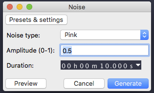

Pink noise is equal energy per octave, so it’s tipped.
What does your screen shot look like when you just generate either white or pink. No recording. The above is a ten second generation.
That is correct.
Pink noise generated by Audacity itself returns a curve like the one you screen-shared.

The dip I’m referring to is when I record noise generated by a third-party site. White noise, pink noise, regardless of third party site, all ends up with the same 650ish Hz dip in it.
Cool. That’s what is supposed to happen. Post it please.
I already verbally confirmed it. Take my word please.
Understand the difference between ‘internally generated tone’ vs ‘recorded from external’ tone.
It is in the latter case that the weird EQ dip is occurring.

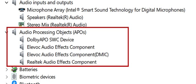

In my Win11 Device Manager, audio section, are the APOs (audio processing objects).
I have read various sources that they can apply unwanted effects, possibly EQ, to recordings made with a DAW such as Audacity or other.
Attempts at disabling, one at a time, any of the APOs I red-boxed, results in the “error opening recording device” message from Audacity I shared in my first post.

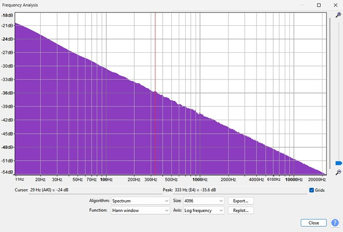

Since you insist on it, here is screenshot of the spectro of pink noise generated by Audacity:
No rises/falls/dips/anything else.
