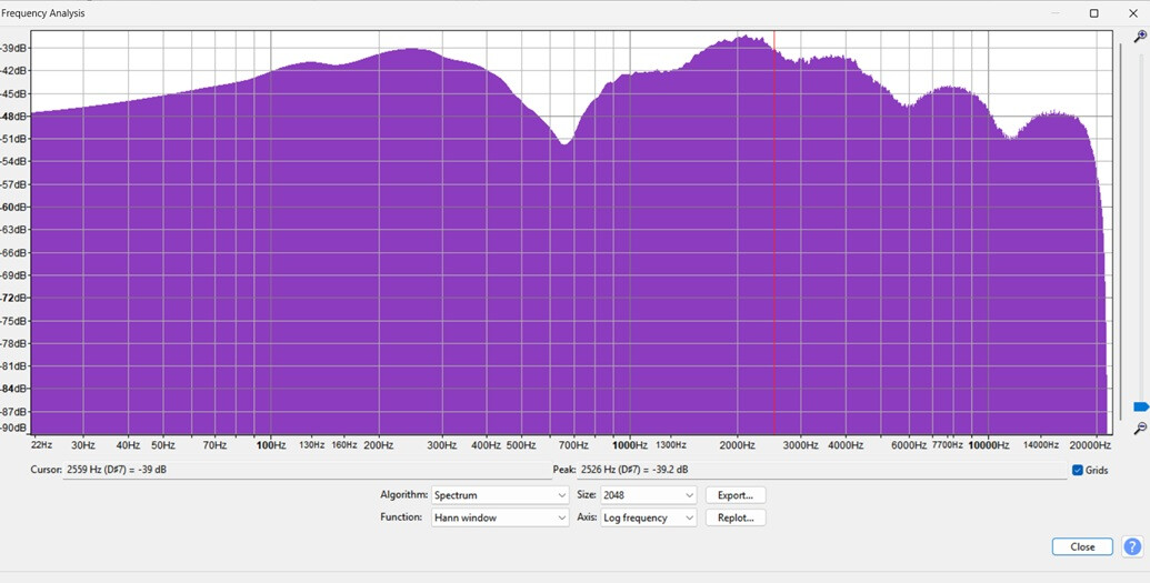

I just found out it is possible to disable any and/or all APO(Audio Processing Objects ) under such tab in Windows 11 device manager, and still record in Audacity.
The important step is, after disabling APOs, is in Audacity to run a ‘Rescan’ of audio devices, under the Audio Setup pull-down.
I did so, with all APOs disabled, but still get the nasty 650ish Hz dip in the spectro of recorded white or pink noise:

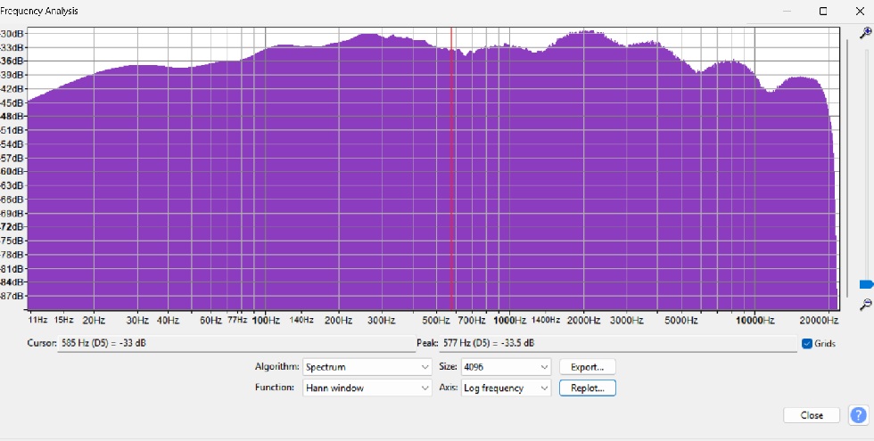

It’s just something I’ll have to live with, and I have created in Audacity’s Filter EQ a preset mirroring the said dip - below, after applying corrective EQ:
Much flatter and more natural sounding, whether via the Laptop Speakers, headphones, or plugged into a large sound system.
And I couldn’t give a rat’s patoot(!) about any rises or falls in content above 12kHz as I can barely hear up that high anyway, lol!

All APOs (audio processing objects) are disabled.
Recording via MME or WASAPI, no matter what combination of levels, returns approx the same spectro as above: a severe dip around 650Hz, and minor bunny hills in the HF.
I can turn down my laptop speakers to a whisper or blast them 100 percent volume, no difference in the spectro of the pink and white noise. Same nasty lower midrange dip.
I just EQ it out and get on with my projects.

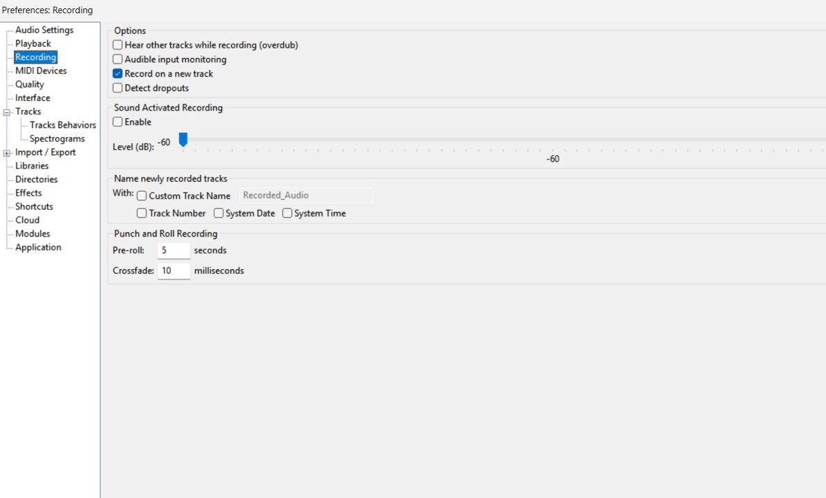

This is EXACTLY what is happening with me. When I listen to the recording the delay, or double play isn’t there, but I cannot record with it like that.
I actually got it to stop by unchecking “software playthrough input” under preferences/recording.
Thanks for that suggestion.
Where, might I ask, is this playthrough input option nestled?
I’ve read of and been told of many suggestions such as this, yet none of them appear anywhere in the settings or prefs. of my version - 3.7.1 - of Audacity.
