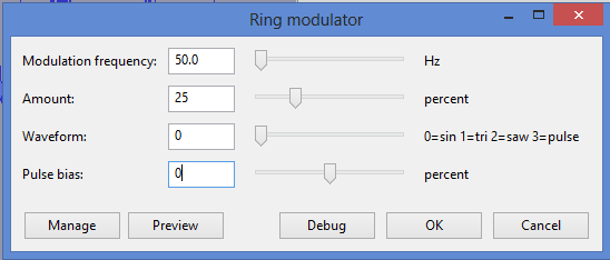

Ring modulator adds some grit, but can sound like a Dalek.
Ok, thanks, Mr. Trebor.
