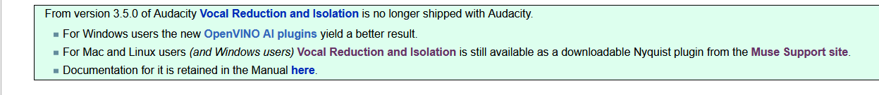

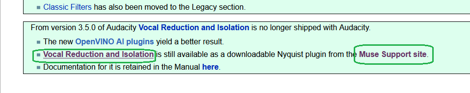

Perhaps worth mentioning in the manual that while the new OpenVINO plugin may yield better results for 64-bit Windows users, anyone else will have to manually install the old “Vocal Reduction and Isolation”, preferably with a direct link to the plugin.
I’ll see what I can do about thatt

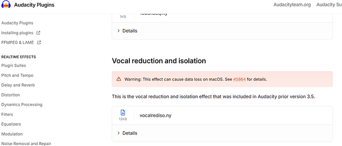

That’s exactltywhat this link does:
But I can add more links there …
Peter
OK so I’ve added more links:
Those links go directly to:
Peter

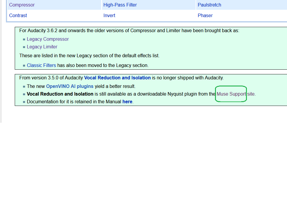

And for Windows versus non-Windows the 3.6.2 manual will say:
Peter
