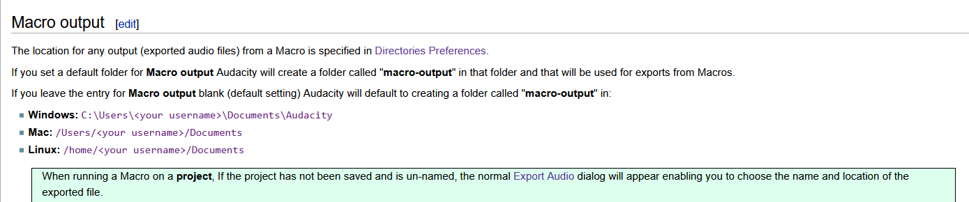

OK, so I have updated this page for the manual for the upcoming 3.4.0 release:
https://alphamanual.audacityteam.org/man/Apply_Macro

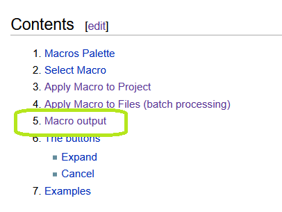

I added a separate new section on macro output
and there is a clear link to that in the contents list:
All the information was there before but it was harder to find I think - so thanks for the “nudge” for this improvement.
Peter.
FURTHER UPDATE
Since a little repetition sometimes never hurts, all three Macros pages in the 3.4.0 alpha Manual bow have the information on Macro output - and all three have entries gor it in thei contents list:
  1. Macros - Audacity Development Manual - top level page on Macros
  2. Macro Manager - Audacity Development Manual - the Macro Manager
  3. Apply Macro - Audacity Development Manual - the Macro Palette
