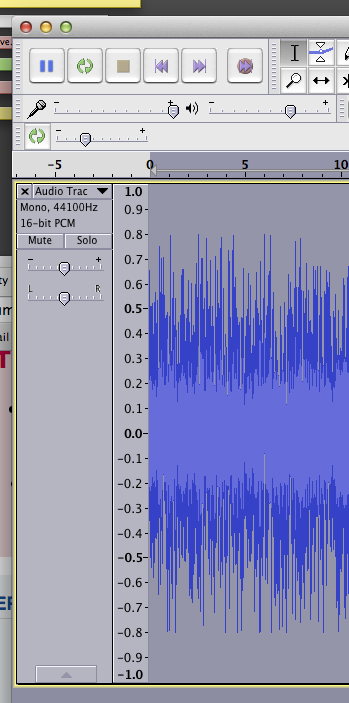

So you can’t get blue waves like this (attached)? Click the picture.
It’s always instructive when you can’t intentionally overload the system. Some part of the system may be trying to “help you” whether you want it or not.
The UCA202 is very conservative. It’s designed to vanish into a music system and work for years without calling attention to itself. We took one apart and it has very high quality, top brand parts inside. Music systems are always competing with each other to improve the customer experience, so that may be normal for your Marantz. It’s a “feature.”
Some distortion can be invisible. If you’re about a hundred years old, you may not be able to hear the extra crispness that happens on high, sharp peaks. If your dog goes and hides in the closet, that may be where your distortion is going.
