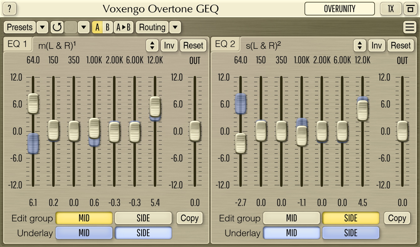

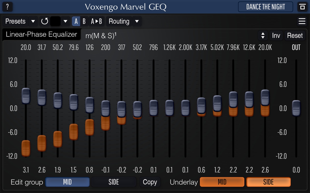

Equalization is the most useful effect. There are free real-time equalizer plugins which work in Audacity …
