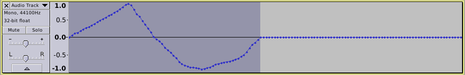

Here is a closeup of the waveform generated by this code:
There are many other ways to create waveforms with Nyquist. The above is just one example.

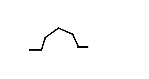

hi steve, can you help me to draw me this shape with nyquist?
where do you want the center line to be?
on the left.
What I meant was, do you want the waveform centred vertically. I will assume that you do.
So here’s a general method that can be used to produce waveforms of any desired shape:
To start, draw out the waveform on a piece of paper - graph paper would be ideal:
Note the positions of the red dots. These dots define the “shape”.
From the above image we can see that the dots are at:
0.0, -1.0
0.5, -1.0
1.0, 0.5 (approx)
2.5, 1.0
4.0, 0.5 (approx)
4.5, -1.0
5.0, -1.0
If necessary we can use trigonometry to work out the approximate values more precisely (see https://www.mathsisfun.com/sine-cosine-tangent.html) giving us points at:
(0.0, -1.0) (0.5, -1.0) (1.086, 0.414) (2.5, 1.0) (3.914, 0.414) (4.5, -1.0) (5.0, -1.0)
In Nyquist, we can store these values in a list like this:
(setf points (list 0 -1 0.5 -1 1.086 0.414 2.5 1 3.914 0.414 4.5 -1 5 -1))

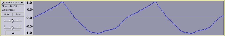

This tells Nyquist to create a waveform that is 5 seconds duration, using the points from our list. By default, PWLV-LIST (like the other “PWL” commands) produces a low sample rate sound, where the sample rate is 1/20th of the track sample rate. The effect of this is that when the waveform is returned to a track, the length will be 1/20th of the length that we defined, so it will actually produce a single cycle waveform that is 5/20 = 0.25 seconds duration. This will be fine for our purpose, but before going on, try running the above code in the Nyquist Prompt effect. You should get a waveform like this:
Are you with me so far? Did that work for you?
