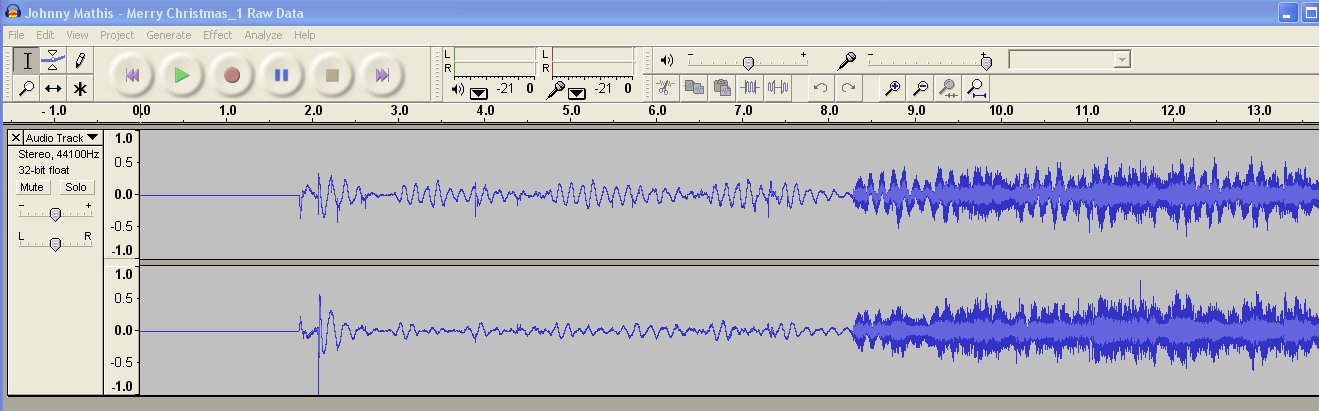

I have attached an example from a recent LP showing about 11 seconds. I have been getting this same pattern on other LPs so I do not think it is the fault of the record.
That is very strange and I can’t say that I recall ever seeing such a problem. My suspicion is that the fault lies with the turntable though I’m far from certain at this stage.
Could you try a little experiment - set the turntable to play at 45rpm and record a couple of seconds from the begining of a record - any record - I’m not interested in the music recording, I’d just like to see if the wiggle changes when the turntable speed is changed.
If you had not been recording you would probably not have noticed the problem at all as the wave pattern is a sub-sonic frequency (about 7 or 8 Hz) and is too low to be reproduced by your loudspeakers. We can “repair” the problem in the recording by using a high-pass filter, but the wiggly wave should not be happening and should be fixed properly.

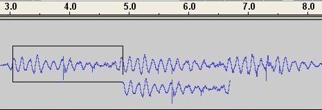

The screenshot was very useful. I loaded it into photoshop then copied and pasted a section of the waveform to compare with a following section:
As you can see the waveform repeats every 1.8 seconds, which is exactly 33 1/3 rpm.
