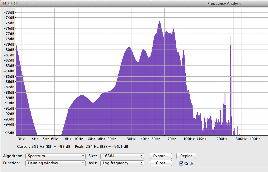

I attached the two pictures of a spectrum analysis you’re going to get when you analyze the silent portion of the two clips. Reading along the bottom, you have a vertical purple spike at 240 in one which is missing in the other analysis. That’s the tone, we’re guessing, which is made by your laptop. It’s very quiet and without the test instruments I would never have found it, but if the conformance started to run into trouble, that’s the first thing that would have to go.
To give you an idea of what that is, 440 is the oboe note at the front of the orchestra and 256 is Middle C. So even though it’s really quiet, it’s also right there in the middle of the piano.

Sorry. Forgot to post the frequency analysis. Click on the pictures.
The steep slope on the left side of the spectrum is DC Offset (not a lot, but definitely there and easy to fix).
That DC Offset error should die in the Normalize step.
