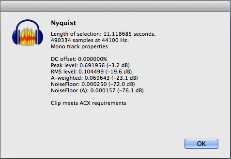

Normalize
Effect > Normalize: Normalize to -3.2 Remove DCThat’s it. The work should pass all three measurements. If it falls below RMS 23dB, UNDO your way back to compression and try 3.5:1 or 4:1.

Will you be so kind as to give a listen and your opinion on a new set of mastering specs? To pass AND sound great?
