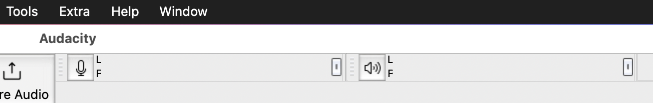

V3.4 Mac - input meters not working, meters are blank with no dB scale showing
Just upgraded to v3.4.2 everything works except the input monitoring - the meters are actually blank without the usual dB scale showing. I can record ok etc, just no monitors! I have matched sample rate and bit depth so is not that. Anyone else have this issue?
I also am not seeing the full meters, just as you described. Bit of a problem as I’m in the middle of project!
Are you running Sonoma OS?
Yes. All the modern advances at my fingertips…still, no red line. Thx

I’m having the same issue on my macbook! I’ve had the meters up until yesterday and then they vanished. I can’t figure out how to get them back, everything else seems to be working normal
Yes they were working fine on my iMac24 previously with OS13 Ventura then one day just stopped. I thought the update to OS14 Sonoma may fix the issue but no luck. Obviously it is just a GUI issue as everything else functions. What OS are you running?
I’m using Sonoma 14.2.1 as well
Same problem here, seems a problem with Sonoma 14.2.1
For what it’s worth I messaged one of the Audacity forum admins asking how to escalate the problem to the team, no response as yet
I received this reply from forum admin, ā€˜This bug is known and logged. There’s no need for further escalation’. Which is good - so now we wait…

Just adding to the chorus. I’m having the same issue with Sonoma on my 2019 15" MBP.
I’ve seen 2 people report that this is fixed in the latest MacOS 14.3 beta.
Yep! It does work now. But I don’t see the option ā€œStart Monitoringā€ anymore when clicking on the meter. Any idea?
