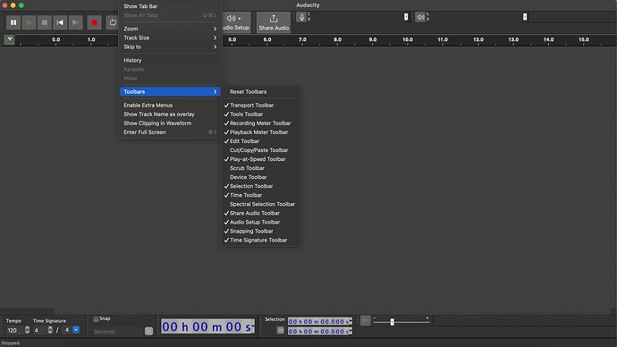

I am not sure what has happened but I have reopened a saved file and now my Audacity has the playback and recording meters missing on the toolbar., it is no longer showing the -60 - 0 or the coloured volume scale.
Has anyone had this issue before and know of a fix?

Unfortunately, I have tried all these options. I have even uninstalled and reinstalled Audacity again. Also, I checked to make sure that the correct recording/ playback devices were checked. I have reset my Mac as well. No luck I am afraid.
I am having this exact same issue! this makes the tool useless for recording as I need to see my levels. Have tried resetting toolbar. removing them and adding them. Reinstalling the whole app… nothing! Fix needed please!
Hello! This bug appears to have been caused by upgrading the OS to macOS 14.2. If you can downgrade to an older version of macOS, try doing that. We’ll try to workaround this macOS bug for Audacity 3.5 in each case.
