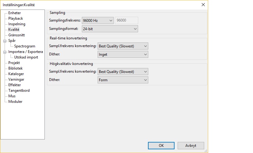

I have a sE Electronics sE X1 USB microphone but the recording level is to low. I have tested to record with Audacity but the recording level is allways below –18 dB. What can I do to increase the recording level? The level switch on the microphone is set to 0 dB and I talk very close to the microphone. I use a 64 bit Intel I5 Lenovo laptop with Windows 10. I have installed the latest Windows driver from sE Electronics webpage (ASIO XMOS USB Audio 2.0). Audacity rev 2.1.2 (.exe installer)
Most USB microphones record low. They are designed for inexperienced users. Low volume is a minor inconvenience whereas high volume produces distortion and is immediately fatal. So it’s no contest.
Audacity doesn’t easily support ASIO, so that software doesn’t do any good.
As a fuzzy rule, I would stick with 44100, 16-bit recording until you get everything working. Then, if you need the extra quality, crank up to 96K, 24-bit. Starting at the higher quality settings right away can fog the symptoms if something goes wrong.
I know of no settings that can fix low microphone volume. If the Windows settings are full up, that’s as far as we can go. I have a very nice USB microphone adapter in the bottom of a drawer because of chronic low volume.
