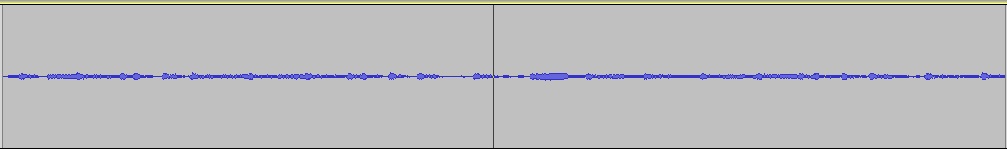

I have exactly the same microphone. It’s not the expected behaviour that the microphone is recording at such a low level. If you connect your headphone to the monitor jack you realize the microphone itself is able to record the birds from the next street. The microphone uses a board from XMOS (http://www.xmos.com) and the XMOS USB Audio 2.0 Stereo Driver version 3.34.0 is the latest driver you can get from sE Electronics. The driver is developed by Thesycon (http://www.thesycon.com) and the product is called “TUSBAudio” (Thesycon USB Audio). They state the driver is compatible with Windows 10 and yes, it works but even if you drag the level slider to 100% it’s still too quiet. There is no boost functionality available.
I just recorded directly in front of my speakers where I played a song at normal loudness (something you can hear :stuck_out_tongue:); have a look at the attachment. When I amplify that so I can hear something it sounds horrible. With voice it’s not too bad because, well, my voice is horrible anyway, but this is clearly not ok.

oh dear, I found the solution! In the properties of your microphone, switch to the “Enhancements” tab and check “Loudness Equalization”…if it’s activated it records just fine with normal levels even at 90% and lower.

if normal means that one can’t barely record anything at level 100% then yes :slight_smile:. But as I said; if you plug your headphone into the monitor jack, you can hear things far far away. So mechanically the microphone is capable to grasp sound. But something inside XMOS is what’s broken; or even a software / firmware bug.
In the meantime the sE Electronics support called back and they confirmed this isn’t the normal behaviour for this microphone. They asked me to send it in for a repair. I believed my “Loudness Equalization” fixed the problem but I did another test; I recorded an instrument and the sound was horrible. So this “Loudness Equalization” really just is a poor mans software amplifier.
