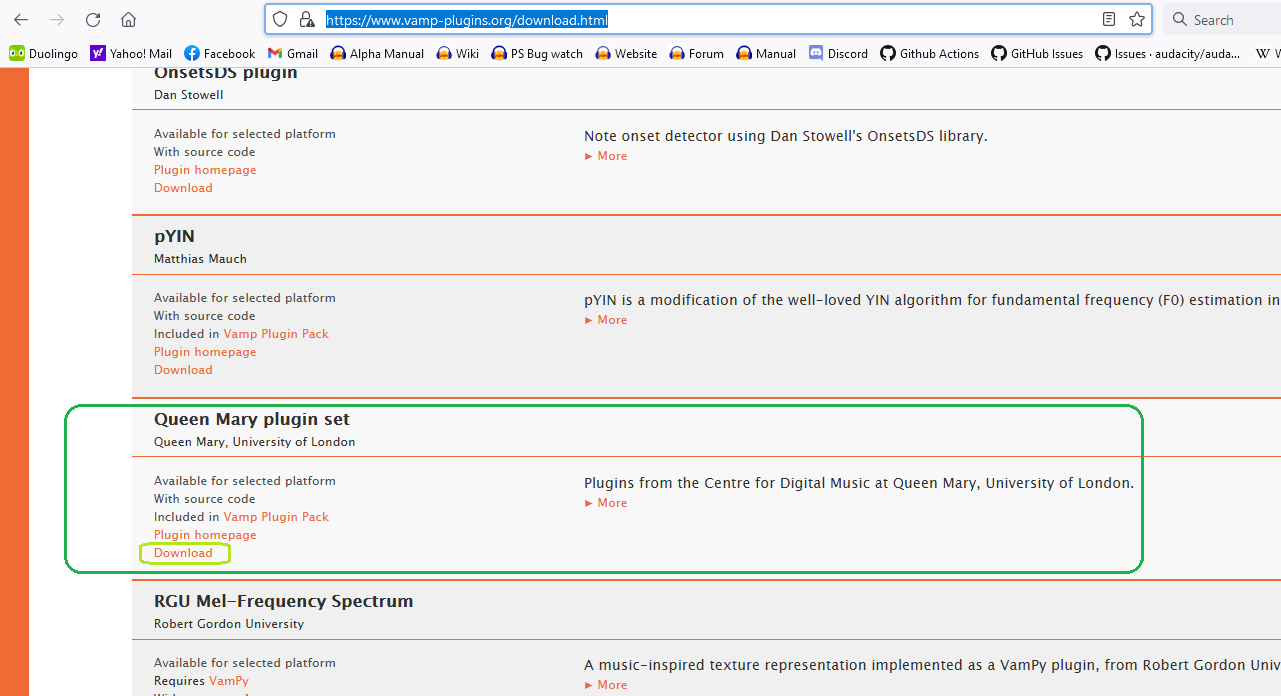

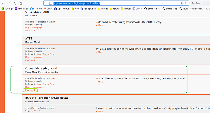

You could try adding the Queen Mary Vamp analysis plugins:
You can download them from here: Vamp Plugins
And see this installation page in the manual: https://alphamanual.audacityteam.org/man/Analyze_Menu#vamp
