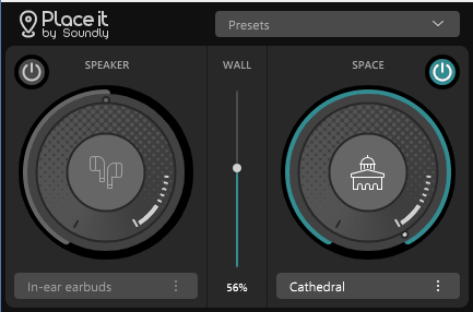

Soundly’s free PlaceIt plugin has a “WALL” slider which may suffice.
There can be clipping distortion if WALL is above 50%
NB: PlaceIt will crash Audacity when applied if the project rate is not 48000Hz
I don’t think that will work but thanks for the heads up anyway because that plugin looks amazing for other things and I will definitely use it!
