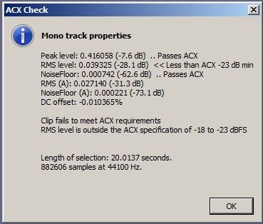

Thanks gents, but I got this, when I ran ACX-Check on the raw file:
(Maybe because I hadn’t done any post-processing? Or also I think I might have been a little too far away from the mics when I recorded; plus I had set recording level down to 75 from the factory default 80; 50-70 were way too low.

Needs some noise-reduction to get the noise-floor down to below -60dB.
There is some reverberation from the room, (particularly noticeable when you say “pop filter”).
A software-tool called an expander can reduce the reverberation in the quiet gaps between words/phrases, but not during speech.
The real cure for reverb is to treat the room with sound-absorbing materials. egg-cartons will not work : you need something heavy-duty, quilt/duvet, thick blanket/curtain/towels, preferably ruched into pleats, or multiple layers of fabric.

The specifications for recording your voice and submission for audiobooks are different. You are almost always going to record (slightly) lower volume than the client wants.
It’s possible to record too high and that can be immediately fatal. Overload damage is obvious and permanent. That’s a bad idea.
AudioBook Mastering 4 is basically three effects, one of them custom you have to download. If you don’t apply some process, you can reach two of the three specifications but rarely all three at the same time. You may have noticed that.
After I got done with Mastering, the background noise was just a little too high (fffffff), so I applied very gentle noise reduction.

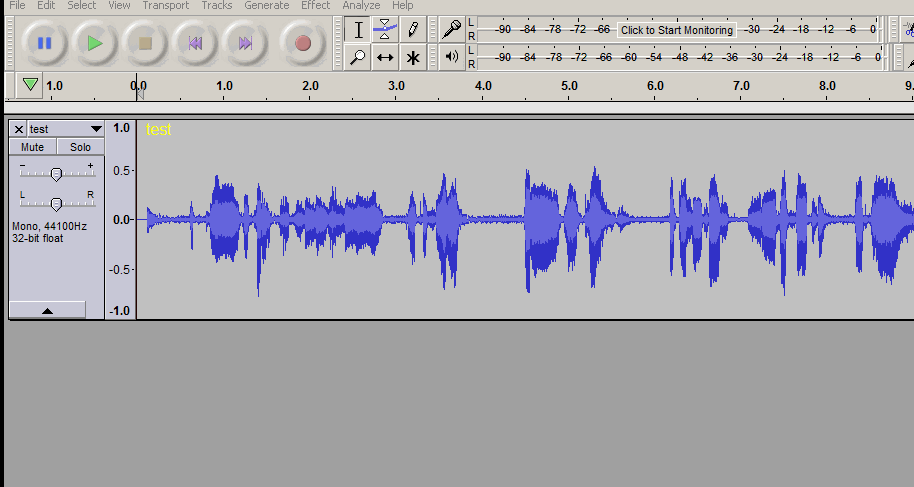

There are two different meters. The recommendation for recording is Gradient. That’s where they turn colors as you get louder. Occasional peaks into Yellow.
Playback and editing uses the two-color Peak/RMS. Those are the two specifications for AudioBooks.

I saw my levels go into the yellow and even red, so I think 80 is too high. Even my tin ear can tell I was coming in too hot and poppy in Audacity and the noise from the PC is going to make this spot untenable. So it’s back to the coffee table. Can’t start building a “studio” just yet. Told my GF about it and she’s like, “You are not going to turn our living room into a recording studio, dude.” So I replied, “Possible $$$,” and she goes, “Where can we find some used moving blankets?”
There is no “80.” The only time you pay attention to the position of the knob is if it’s all the way up or down. All other times you report the bouncing sound meter. If your voice is too crazy and gives peaks into the yellow, orange and red, then it’s too high. Back off. Occasional peaks that just start to turn yellow is good.
As you found, volume too loud is pure evil, noisy and in most cases permanent.
There is one other case for paying attention to the knob. You set up for a second show and the knob got bumped from where it was last time. In That Case, knowing where the knob was is valuable. This is obsessive engineer talking.
But in all cases check the sound meters before you shoot anything.

The posted test is too loud, but you knew that going in. The pop at 16 seconds may vanish if you put the foam sock on there. Wind noise and P-Popping are cousins. Then back off the volume until you get light yellow peaks every so often.
