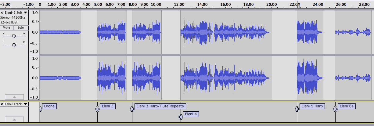

I’m very new to Audacity. Currently using 2.0.3. I’ve imported several sound clips into a single track on Audacity. There is a bit of space between each clip. I would like to be able to toggle forward through the various clips. They are for a stage production and I want to be able to start the audio without having to look down at the computer too much. I have the various clips labeled, but I can’t figure out if there is a way to launch a clip, let it play, stop with the space bar, and then jump to the next clip. Is that possible?
I’ve attached a screen shot of my project so you can see what’s going on.

The labels are sticky as you no doubt figured out by now. Theatrical cuing came up before and I don’t remember what we did. Searching.
Managing label wiki goes for pages, but jumping to the sound selection does not. Still searching. Koz
No, can’t find it. We’ll need to wait for one of the other elves. Koz

Click in the text of the first label. Hit the Play button then Stop button to Stop if needed. Or hit ENTER on the keyboard to close the label edit, then SPACE to play the labelled audio. Hit SPACE again if you want to stop playing.
If you used Play and Stop, just hit TAB on the keyboard to move to the next label, then Play and Stop buttons again. Repeat the steps to work through the labels.
If you used ENTER and SPACE, hit TAB twice to move into the second label. ENTER then SPACE again. Now TAB three times to the third label and so on. Unfortunately TAB (or some shortcut) really ought to move forward from the current or nearest label when the label is closed for editing, but it doesn’t. :frowning:
If you want to cycle backwards through the labels, SHIFT + TAB.
TAB or SHIFT + TAB to navigate the labels only work when the yellow focus border is in the label track. If the focus border is not there, use UP or DOWN arrow on the keyboard to move focus into the label track.

Sorry if I am not picking this up RhythmKats, but can you explain exactly what you are trying to do? Are you waiting for some event on the stage to happen, then you play the next clip? But you want to use the keyboard to play the next clip, not the Play button? If so, that’s exactly where TAB from the current or nearest label would help (if you are prepared to label the clips). Or, as Robert suggests, open the Keyboard Preferences, choose the Command category and set Play/Stop to something that doesn’t type in a label like a function key, or COMMAND - SPACE or OPTION - SPACE.

Yes, I’d like to use the keyboard and just press one button because I will be playing an instrument as well. I see what you mean by using “tab” to set the cue and then clicking play in the transport bar. That would indeed work, but I don’t want to have to deal with the mouse.
I messed around a bit with setting a new command as suggested, but couldn’t quite figure it out. The keys I chose were mostly assigned to commands already. I’ll have to investigate this further.
