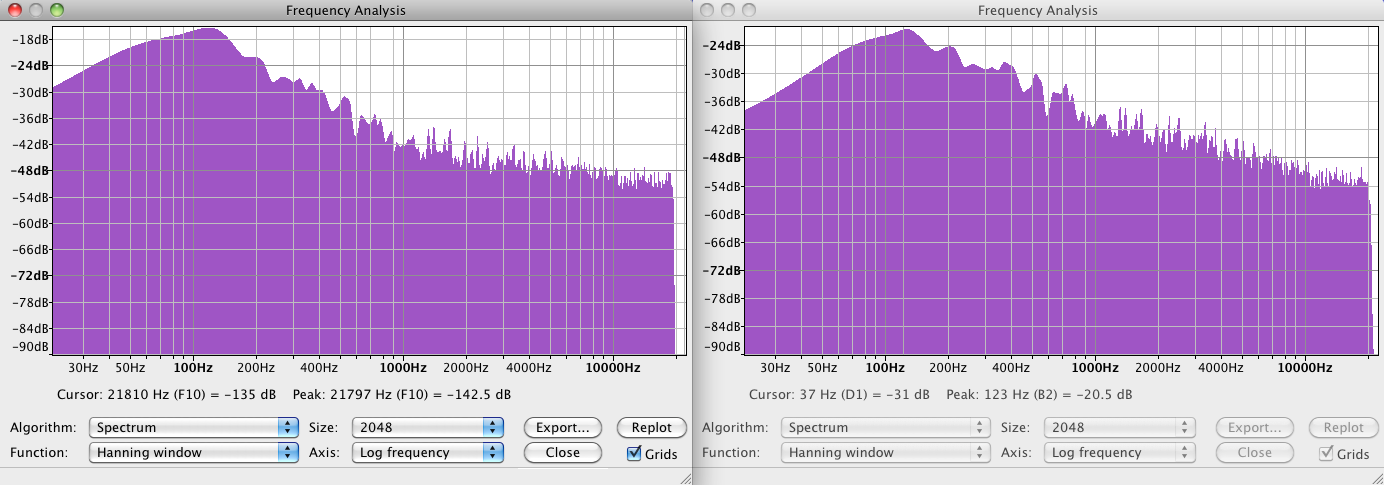

Attached are Audacity screenshots of spectrum plots of a 5 second segment of a 1979 recording of Spyro Gyra’s “End Of Romanticism” aiff file from the 1996 remastered “Morning Dance” album on Amherst label, the time I bought my copy. From the spectrum plot of the unedited original wave form would you say that is a professional or quality remastering job?
It sounds thin, flat, high pitched with very little bass on every device I play it on except on my old home stereo with large box speakers where I have to severely EQ the treble/bass adjusts. Note the extraneous data representing highlights from snare drum and cymbal hits between 10K to 20K Hz. That’s ridiculous! A negative adjust of -1.5 semitone pitch in Audacity’s “Change Pitch…” fixes it.
Would you say that is an indication of poor recording or remastering? I’m at a loss.

The spectrum plot of the original vs my Audacity edits representing improved sound…
Audacity Wave Stats… measures my edited version at around -13db RMS, the original -18db. It sounds a whole lot better listening on my Sony headphones even better than the improved Amazon mp3.
Does my edited version going by the plot spectrum break any sound engineering quality standard rules?

You can’t tell audio quality from a spectrograph. And it is impossible to tell if the problem was already present in the recording, was introduced by the mix, or the mastering…
The same goes for remastering. Unless you also have the original version to compare with, you can’t tell if the remastering was any good.
Your corrected version is almost 6 dB louder. That doesn’t break any rules, except EBU128, but since this is only for your pleasure, it doesn’t matter.
And the most important rule in audio engineering is still: “If it sounds good, it sounds good”. :mrgreen:

Well I had to check to see if the Amazon mp3 samples were really altered from my 1994 CD re-issue, so I downloaded one of the 89¢ mp3 selections off the Amazon Amherst Records label page and analyzed the bass region and sure enough the mp3 has a 7db boost in the 50Hz region only (hopefully my car’s subs will reproduce). See attached plot spectrum.
The mp3 still is reproducing slammed to the wall 20K data as the 1994 aiff which puzzles me because that has got to be noise. Unless they mic-ed the symbols I can’t imagine what detail is being preserved to hear over what amounts to a lot of loud high energy music.
