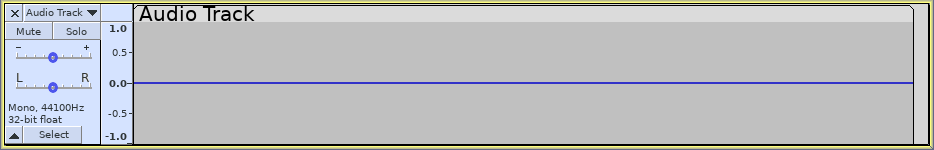

Since I updated from 3.0.5 to 3.1.0 the waveform/signal line is thick, even when there is nor signal running into Audacity.
I already tried changing the dB range that audacity shows on top, but the waveform line is still thick.
This is how it used to be with all older Audacity versions:

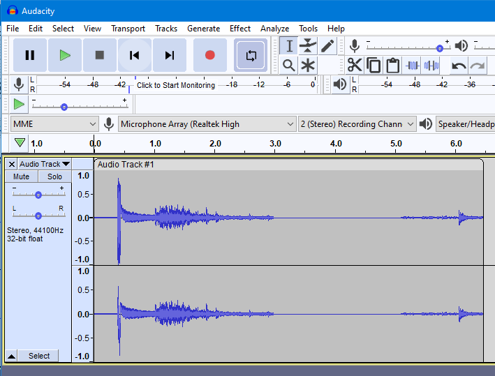

This is now with Audacity 3.1.0:
Any Ideas on how to fix this?
It does not matter, if I denoise my mic to the point where no signal is produced when quiet, or if I mute it…the db Meter on Top is showing absolutely nothing (showing down to -60dB) but the waveform shows the constant line so thick as if there was a constant signal active with 3.1.0.

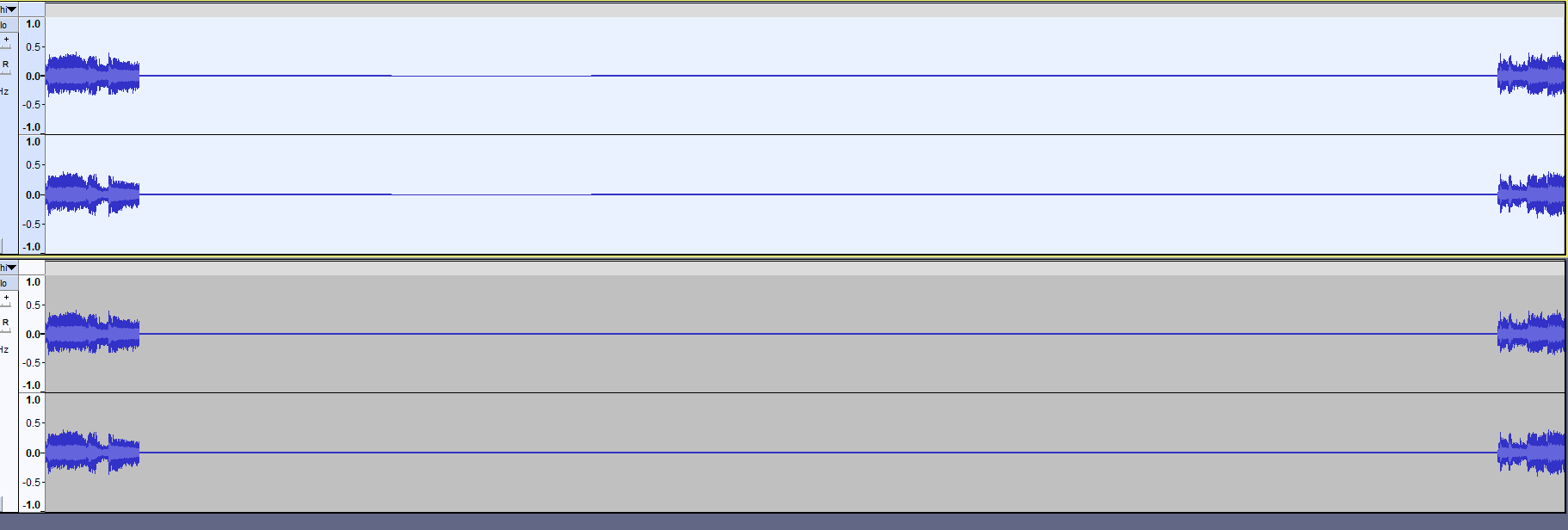

Here a recording with short test voice, then mute and a small section at the beginning was marked and silenced with Ctrl+L
Same Recording in spectrogram view:
So it’s clear to see that even with absolutely no signal, the line is thicker than the area that has been silenced with Ctrl+L
The “thick line” is showing you that there is a low level signal (probably just a bit of noise). If you zoom in vertically you will be able to see that it is a waveform (see: https://manual.audacityteam.org/man/zooming.html)

OK so I dis some testing - first three images are with 3.1.2 second two are with 3.0.5
this is “silence” recorded with 3.1.2 - and yes the line is thick (thicker than 3.0.5 - see image #4 below)
I thun used Ctrl+L to silence the section from 5-7 seconds - and yes that shows as true silence
I then amplified the clip - and we can see it’s not silence at all
so I switched to 3.0.5 to repeat thee experiment - and yes we see a nice thin “silent line”
I then amplified this - and we can see the recorded sigan is not silence in 3.0.5 either
for completeness I undid the amplify, silenced from 305 secs and then redid amplify
So yes that appears to be a slight visual difference from 3.0.5 to 3.1.x - but it may be that 3.1.x is swing a truer pictur and when quiiescent recording either my sound could is making a little “noise” - or it’s picking up “room tone”.
Here is some noise with an RMS level of around -50 dB in Audacity 3.0.2
Here is the same track with the track height reduced sightly:
Here is the same audio (from 32-bit float WAV) in Audacity 3.1.2:
and finally, the same audio in Audacity 3.1.2 with the track size slightly expanded.
At around -45 dB peak / -50 dB RMS, with the default track height, the waveform is on the threshold between one pixel high and two pixels high.
Audacity does not currently have sub-pixel rendering, so audio at this level may display as 1 or 2 pixels, depending on whether the rendering considers it to be closer to one pixel or two.
If there is sufficient track height, then the vertical height becomes closer to three pixels, and displays like this:

The way that audio samples are translated to pixels is extremely complex. It is not just a simple mapping of “sample value => pixel position”. At normal zoom levels each pixels represents many samples, and if there is room to do so will display both the peak level (dark blue) and the RMS level (light blue). The code also needs to be as fast as possible so that you are not waiting longer than necessary while Audacity redraws the waveform. If you resize the track vertically, you may observe that Audacity redraws the waveform to the new scale extremely quickly, even when there are millions of samples within the view.
If you silence a selection of audio (Ctrl + L) then you should see it as a thin (1 px) line. Is that what you see?
Noise with a peak amplitude of around -40 dB may show as 1 px or 2 px - it’s a borderline case and may do either depending on the track height, though with a very big track height it may show as 2, 3 or even 4 px high.
