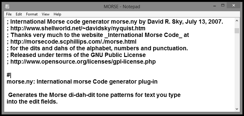

It’s a bit old post, but I was also looking for the solution
