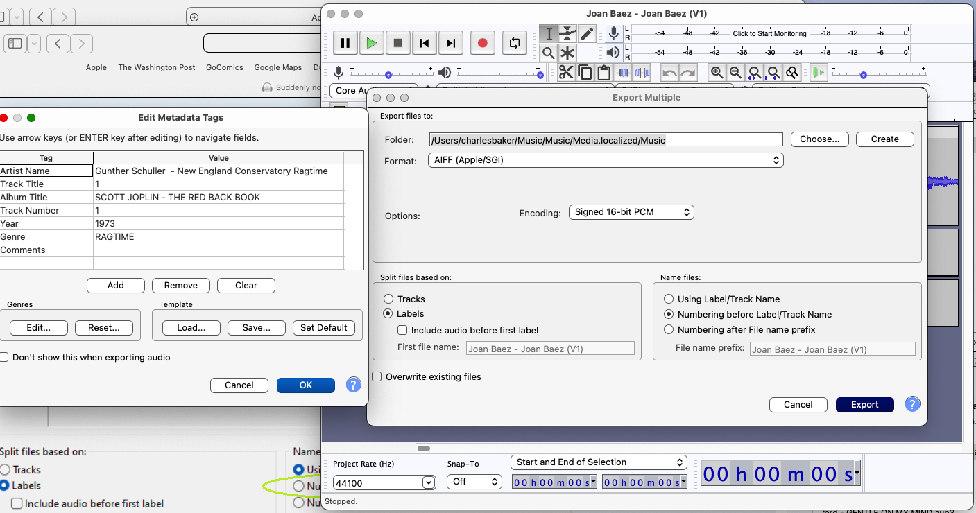

Hi Waxcylinder, thanks for the try. I realize that my posting is wordy, but I did state the status of the radio buttons.
Attached is a screen shot of a sample project. I have no idea what caused the system to stop functioning properly, but if I inadvertently flipped a switch I can’t find it and the manual is no help at all. I anxiously look forward to the manual rewrite that will allow searches.
Thanks for your help.

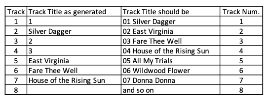

Trackman, thanks for hanging with me. You didn’t notice, and neither did I until reviewing after posting, that the contents of the export Meta display was an example of my second named problem, i.e., the meta displayed on export was that of the prior project. That was due to my stupidly hitting ‘Set Default’ on the prior project. That problem now solved.
As to the Track Name problem, again, it was working just fine through several projects. The problem started for some unknown reason between two editing sessions. As stated before, Audacity may or may not have been left running, both iterations surely had occurred between prior projects, and the Mac was put to sleep – not shutdown. As I have flailed around trying to solve the problem it HAS been shutdown and cold-started, i.e., not just ‘Restarted’, but the problem persists.
I am attaching below a pdf of a table I created in Xcell showing what meta data is displayed (and what should be displayed) for a few tracks.
And, I presume, so on. I quit attempting the export.
Again, before the “incident” the track numbers were always presented as 01, 02, 03, etc. After, they are as above: 1,2,3, etc. And, by the way, this problem is the same now on any project I attempt to export, even projects that were previously successfully exported and tested to observe if they had the same issue.
I believe I have flipped a toggle somehow. I don’t think there is anything with the software, but I don’t understand how I have screwed it up.
Your patience and assistance is appreciated. Thank you again.
