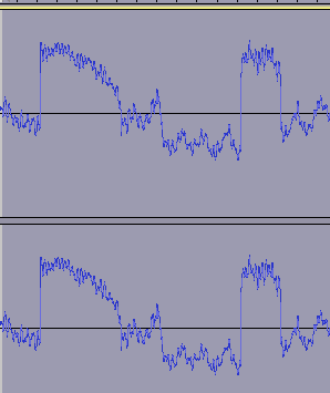

If you magnify the noise on the timeline, you find a great many sharp, vertical transitions between segments of music (three in this pix). It’s very unlikely to get that kind of damage in analog land. It has to be during or after the signal becomes digital. It’s very difficult to believe that adding two digital signals together can produce that, but it’s no stretch at all to get that by dropping bits or bad bitstream management. Koz

While I rip the waves apart, I found that the show is mono. There are two sound channels there, but they are identical. So if you think you’re capturing the work in stereo, you’re not.
This could drag us straight to wiring problems on your computer.
USB shouldn’t be acquiring noise from physical sources of noise once the signal is digital. USB can be prone to RF noise at the sampling stage, just before it becomes digital, but I agree Sombunya’s MP3 does sound like some kind of “stream management” problem.
