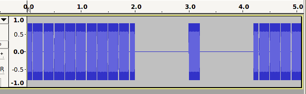

I notice that in “track.png”:
“allow silence less than” = 2, “ignore sounds less than” = 0.5, we get the whole 4.2 s as one “sound”. So even if no one else wants it I would still like an option not to treat ignored sounds as silence.
I agree handling of crackle between wanted sounds seems to work well with the new control “ignore sounds less than”. Though “shorter than” is I think more grammatical for lengths than “less than” .

The controls operate in the order of their appearance in the interface, so we have:
  1. Allow Silence shorter than:
  2. Ignore sounds shorter than:
  3. Minimum label length:
“Allow silence” happens first, so we are “allowing” the silence from 1.0 to 2.0 and the silence from 2.2 to 3.2, so the entire track from 0.0 to 4.2 is treated as one sound.
If we set “allow silence” to less than 1 second then 0.0 to 1.0 and 3.2 to 4.2 will be labelled individually.
If we want the sound from 2.0 to 2.2 to be labelled, then “ignore sounds shorter than” must be less than 0.2 seconds. (The sound is not ignored).
If we do not want the sound from 2.0 to 2.2 to be labelled, then “ignore sounds shorter than” must be greater than 0.2 seconds. (The sound is ignored).
In this example we are not treating the 0.2 second sound “as silence”. We are “ignoring it”.
If we were treating that 0.2 seconds “as silence”, then we would have silence from 1.0 to 3.2 seconds, which is a total of 2.2 seconds. That would be greater than our “allowed silence” so the silence would be recognised and the sounds 0.0 to 1.0 and 3.2 to 4.2 would be labelled individually. That is not what happens.

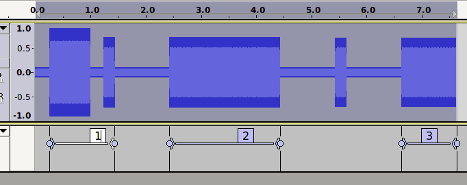

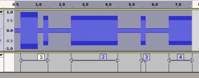

Here is an example of how it will work.
First, this is what happens with the current Sound Finder with the following settings:

The silence from 1.0 to 1.2 seconds is “allowed”, so we end up with 4 “sounds” detected as shown.
Now with the new feature.
One of the detected sounds is very short. Label number 3 marks a sound that is only 0.2 seconds duration.

Here is what happens if we set the new control to 0.3 seconds.
Question: Should the sound from 1.2 to 1.4 seconds be “ignored”?
Answer: No. That sound should not be ignored because as far as Sound Finder is concerned, that is part of the sound marked by label 1.
Question: Why is the sound from 1.2 to 1.4 “part of sound 1”?
Answer: Because we have allowed the short silence from 1.0 to 1.2, so “sound 1” starts at 0.2 seconds and ends at 1.4 seconds.
