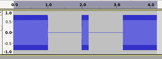

Consider this example:
Lets assume that “Allow silence between sounds less than (seconds)” is set to 0.5 seconds.
The current behaviour is unambiguous. The silences in the region 1 to 3 seconds are less than 0.5 seconds, so they are “allowed” and there will be just one marked sound from 0.0 to 4.0 seconds.
If we have an additional feature; “Ignore sounds shorter than [seconds]”, the correct behaviour is less clear.
If Ignore sounds shorter than [seconds]" is set to 0.5 seconds, then one might assume that the “clicks” between 1.0 and 3.0 seconds will be ignored (because they are shorter than 0.5 seconds). If those sounds are ignored then the sum total of the silences will be greater than 0.5 seconds and two sounds will be marked, one from 0.0 to 1.0 and one from 3.0 to 4.0.

Ignoring what algorithms could logically do, both track.png and crackle.png would have (I suppose) a “reasonable” outcome for someone wanting “ignore sounds shorter than” if the starting tone and ending tone were both marked as separate “sounds” (with no other sounds marked).
1. Ignore sounds shorter than [seconds] IF AND ONLY IF separated from other sounds by more than the “Allow silence between sounds less than (seconds)” duration seems to mark the entire audio as one sound in both track.png and crackle.png. If I have that right, that’s clearly not OK for someone wanting to “ignore sounds shorter than”.
2. Allow silence between sounds less than (seconds) IF AND ONLY IF both bounding sounds are greater than the “Ignore sounds shorter than [seconds]” duration seems to mark the starting and ending tone as separate “sounds” (with no margin extending into “silence” and with no other sounds marked) in both track.png and crackle.png. If I have that right, that’s clearly “reasonable” for someone wanting to “ignore sounds shorter than”.
However in track.png I or someone else (and maybe even common sense??) might prefer to include the silences (either side of the short noise) in the starting and ending “sounds”. Why? Because that includes a silence “shorter than” that I said I wanted to allow, but doesn’t include a sound shorter than that I said I wanted to ignore. All my settings are satisfied.
In crackle.png I or someone might prefer the first sound to finish where the first crackle peaks, and the second sound to start after the final crackle peaks. I would not want to label each crackle or a group of crackles because the crackles are shorter than “ignore sounds shorter than” EVEN IF the silences between the crackles are shorter than “allow silences shorter than”. Same reasoning with the single “noise” in track.png. But if have a continuous silence shorter than “allow silences shorter than” that is NOT broken by sounds shorter than “ignore sounds shorter than”, I DO want to allow that silence in the sound. Maybe this is too sophisticated/conflicting for an algorithm?

There would still be a “problem” if someone had content that was typically like track.png but then they also had intermittent crackle as in crackle.png. They would never be able to set allowed silence high enough for what they really want if the crackle was as loud as that. Maybe not our “problem”, though.
But even with no crackle (track.png), there is no setting that will mark the first sound from 0.0 to 2.0 and the second sound from 2.2 to 4.2, is there?

  • If “allowed silence” is less than 1 seconds and “ignore sounds” is less than 0.2 seconds, there will be three labels (0.0 to 1.0, 2.0 to 2.2 and 3.2 to 4.2)
  • If “allowed silence” is less than 1 seconds and “ignore sounds” is more than 0.2 seconds, there will be two labels (0.0 to 1.0 and 3.2 to 4.2)
  • If “allowed silence” is more than 1 second, there will b one label (0.0 to 4.2)
I presume that the case that you are putting forward here is:
“allowed silence” is more than 1 seconds and “ignore sounds” is less than 0.2 seconds
Are you suggesting that the silence from 1.0 to 2.0 should be counted as part of the first sound (because it is “allowed”) and the silence from 2.2 to 3.2 should be counted as part of the second sound for the same reason, but 2.0 to 2.2 should not be included as part of either because it is “ignored”?
If so, I don’t think that strategy is workable because within normal audio there will commonly be very short silences that we wish to allow and these may occur at frequent intervals, so the duration of sounds between will also be very small (consider zero crossing points). We don’t want to split a sound just because there are a couple of brief silences in close succession.
Also, labels from 0.0 to 2.0 and a second sound from 2.2 to 4.2 would imply that sounds are found (this is the “Sound Finder” effect) from 0.0 to 2.0 and from 2.2 to 4.0. I don’t think that this is really desirable on two counts -
(1) the first sound actually ends at 1.0, not 2.0
(2) the “gap” between the labels (2.0 to 2.2) would imply “no sound” in that region. Not only is that not the case, but if it were the case then it should be allowed because it is only 0.2 seconds duration.

Of course. With that simplistic “track.png” example it might be “common sense” as I suggested to put that case, but that is without considering how an algorithm would handle real world audio.
Yes, but user asked for a second of silence (in fact, up to two seconds in the original example) to be included as “sound”.
It is the case, user asked for a sound as short as that to be excluded.
It could only be allowed if the algorithm was treating the ignored sound as silence.
I think an algorithm “ought” to be able to produce what I suggest in the artificial “track.png” example, and you do have to explain there why the allowed silence setting appears to be “ignored” because I am sure it will be asked.
There again, some may prefer just the sound to be marked without the silences they asked for where a “too short” sound intervenes.

Following this rule, 1a would become:
If there is a period of silence at the end of the selection, If it is of less duration than “Minimum duration of silence between sounds”, it is NOT added to the last sound.
(because the silence is not “between sounds”).
The case for Track.png would also be that the silences 1.0 to 2.0 and 2.2 to 3.2 would not be added to either of the detected sounds (because the sound from 2.0 to 2.2 is being ignored so the silence is not “between valid sounds”).
So in all cases short periods of silence can only allowed if they are between two marked sounds.
I would suggest adding the word “valid” to “Minimum duration of silence between sounds (seconds)” except that it is already rather long.
It’s possibly worth remembering that there will still be options for “Label starting point” and “label ending point” so some amount of silence can be added each side of the detected sounds.
