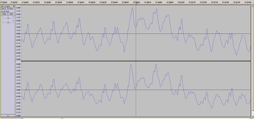

I announced a short track with the mic in the X2U and then did a similar track with the mic plugged into a Peavey PV6. The X2U was cranked all the way up and produced a comfortable track. The Peavey still had over 30dB of boost left to add if needed – the faders were only half-way up and the microphone trim was at 3/4.
The X2U doesn’t need any fancy software; it looks like a standard audio device. Plug it in and go. I didn’t try it on Windows. It has provision to play computer music into its own headphone socket, so if you did it right, you could do a complete sound-on-sound session. It’s 16-bit. I used it both at 48000 and 44100.

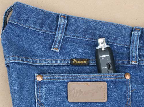

You can’t tell from the sales illustrations how small this thing is…

That is confusing to me, as the peak indicator has nothing to do with the output line level (-10 dBu). So I gave up on the emails (no offense, compared to some other companies Cakewalk were great to reply at all and the replies were relevant if slightly vague; but it is a noreply system so you have to jump through hoops again on the Cakewalk web site every time you would like clarification). Instead I ran a test for clipping when recording the same track (from the Thelma Houston Sheffield Lab LP via my Rotel RA-1312 pre-amp line out) with:
  1. The UA-1G peak indicator just off (which required the UA-1G input level knob at 2 o’clock and gave recorded peaks near -10 dBFS)
  2. The recorded waveform peaks around -1 dBFS (which required the UA-1G input level knob at full scale and illuminated the UA-1G peak indicator much of the time).
    In both cases, the Audacity = Windows input level slider was left at 100%. From the zoomed waveforms (note the different vertical zoom levels), I think we can conclude that:
(i) With this kind of (consumer line out) signal level the UA-1G peak indicator can indeed be ignored (it seems to be set for -10 dBFS digital output).
(ii) The input level knob can be set to full scale without analog clipping.
(iii) The recorded waveform can be used to confirm that there has been no digital clipping.
(iv) Edit: Noting that the noise floor increases by almost the same amount as the recorded peaks (8-9 dBFS) over this range (2-5 o’clock on the input level knob) the S/N ratio is not going to be improved much (sorry, I got this wrong in the initial post).
The recorded tracks sounded fine to me. Given that plans are afoot to implement 24-foot recording in PartAudio / Audacity for Windows: if you have equipment that can benefit from the lower noise floor, or if you believe in other magical benefits of 24-bit recording (and you don’t pay too much attention to that PEAK LED), the UA-1G may be worth the extra cost. Unfortunately, you may still then need to compile a private version of Audacity with ASIO to get the 24-bit recording capability (or use an ASIO-capable program like Sonar LE which is supplied with the UA-1G device). If you want those extra ins and outs the UA-1G is an obvious choice.
