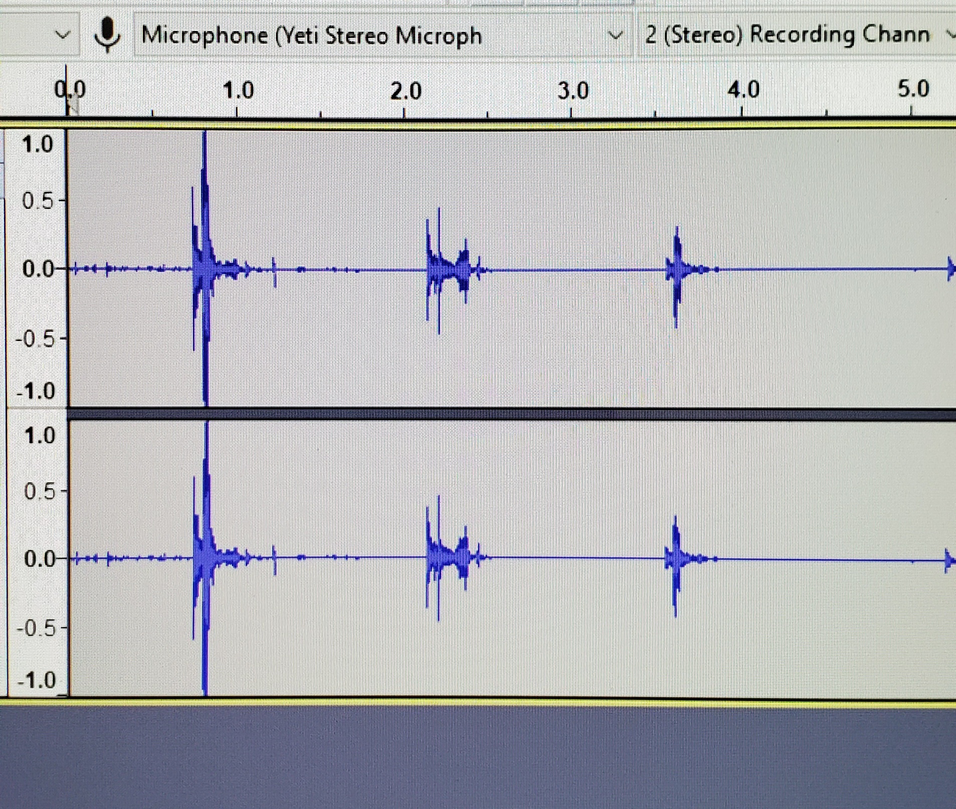

Yep. Went through all that last night. I did it again this morning just to be sure. Still doing the same thing. I even tried recording in mono in audacity, since the yeti is in stereo. Same results. And again, with two different yetis. I attached a picture of the recording. The wavelengths show my voice recording levels for the left, middle, then right. You can see how its recording lower on the right side. And when playing back, you can tell its just the left side picking up the sound.
The waveforms look identical to me…
I wouldn’t expect them to be exactly identical. There will be variations in the analog electronics and in room acoustics. And if left & right are identical there’s no actual “stereo”.
There’s also no point in recording a single voice/instrument in stereo. If you have one person on the left and another person on the right, and maybe someone in the center, that’s stereo. and of course you won’t get “perfect stereo” because both mic elements will pick-up some sound from all directions.
…BTW - You’re also [u]clipping[/u]. You shouldn’t be hitting 1.0 ( 0dB or 100%) while recording. You can turn-down the recording volume knob on the Yeti and then Amplify or Normalize after recording if you wish. There’s no problem with low digital levels but if you record too “hot”, clipping is distortion.
