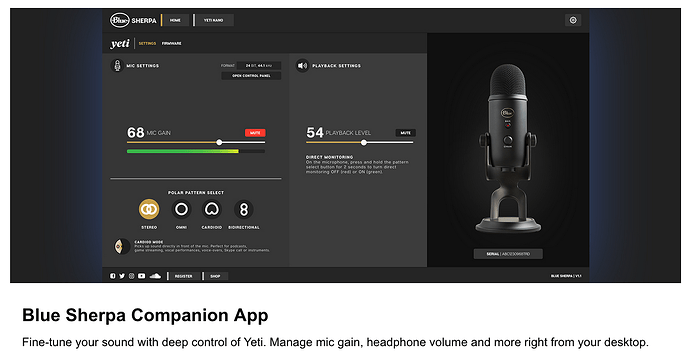

Blue offers a software package called “Sherpa.”
I got that from the Yeti information pages on the Dell web site. So they absolutely expect all this to work.
