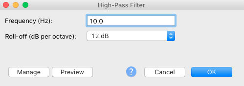

Seems like there is a rather big DC offset.
Try this:
Go to effects ----> Select High Pass Filter,
Then enter 10 Hz for frequency and roll-off of 12dB/octave.
