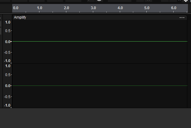

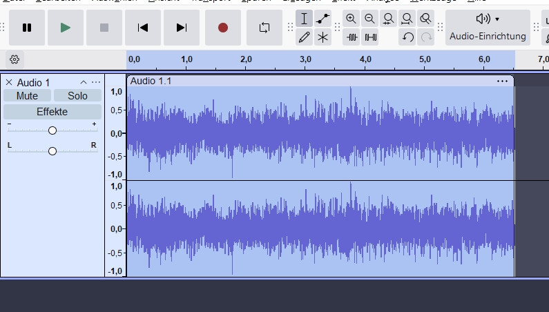

Record room noise with the damage on one track. Say 5-6 seconds. Stop. Select the whole performance.
Effect > Volume and Compression > Amplify. Apply as much amplification in one pass as the system can do. Do Not Allow Clipping.
Post what that looks like on the forum. Export the performance as WAV (Microsoft) and post that file. The system should allow you to do that.
Hi Kozikowski!
I did as requested. Visually the result looks as following: (50dB gain - max.)

You posted just plain recording. I’m looking for your noise damage on one track and normal room sound on the other. I want to analyze the comparison.

The asymmetry is a visual render thing …
render-weird
Agreed. You can see from the screen shot of the amplified track that both channels are identical.
