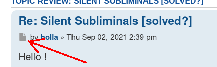

When referring to specific forum posts, including posts that have plug-ins attached, please include a link to the post.
You can copy a direct link to the post by right clicking on the little grey icon next to the person’s name in the top left corner of the post:
