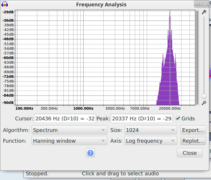

Audio that has hidden (silent) content that has been created by amplitude modulation at a high frequency (one of the most common forms of “silent subliminal”), will typically have a high peak in the audio spectrum (see: Plot Spectrum - Audacity Manual).
In this example, the highest peak is shown as 15992 Hz. The actual frequency used to create this was 16000 Hz. One can usually assume the the frequency will be a round number as I doubt that many people would use a frequency like 15992 as the carrier frequency, unless perhaps they believe that 15992 has some special / magical significance.

This is what the spectrum looks like:
Note that the spectrum has a peak that coincides with horizontal line in the spectrogram. So to decode AM modulated audio, you are looking for that peak in the spectrum / line in the spectrogram track view.

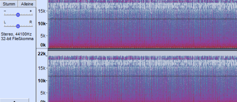

I opened a silent sub that I bought in audacity and it looks like that (screenshot). I was wondering how they do that because my when I use the subliminal.ny from this forum, the waves are not cut off above 22k…
