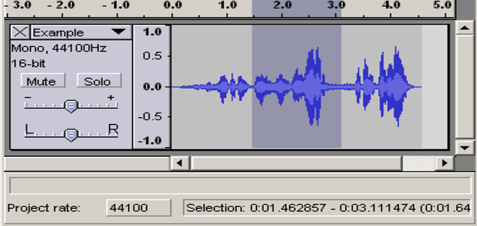

I’d like to see that shrink/expand button at the bottom of the Track Control Panel made less wide - that would give us space for a “Select” button which would go where Koz has his red patch.
That way it should be pretty clear what you have to do to select the track.

I am deeply aware of the number of times we have had to tell users on this Forum how to select a whole track by clicking in the Track Control Panel (carefully in the white space).
Adding a “Select” button would not only be “discoverable” - it may help some folk avoid accidentally nudging the pan or gain sliders.

Well it seems to me from looking at the two buttons in the upper part of the TCP (Mute and Solo) that there would be plenty of room in a button of that size for the text “Select”. And Given the the shrink/expand button at the bottom of the TCP occupies most of the horizontal button space at the bottom of the TCP - it would seem that we could shrink that button to half-width, easily making room for a “Select” button.
Over the years I’ve often wondered why the shrink/expand does fit the whole width as look would look cosmetically neater - but I realize that we need that little white-space square in order that the user can click in there to select the track.
This is why Koz so often posts his image with that white square in red.
And I remain keen for this to be a “quick win” - that can be done without “considering the other elements of the panel” apart from, that is, the oversized shrink/expand button.

As I said above it replaces the red square patch at the bottom of the TCP that Koz often draws (see below)as a target for users for selecting the whole track.
I.e. at the bottom of the TCP alongside the “shrink/expand” LBT button - making the “shrink/expand” button narrower to accommodate the “Select” button. And geing there it remains visible when the track is “shrunk” or contracted really small.
Not sure whether the “Select” should be to the left or the right of the “shrink/expand” button.
