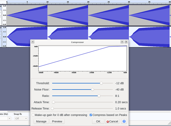

In this screenshot,
The upper track shows the original audio.
The lower track is after applying the compressor with the settings shown.
The entire second track has clearly been processed.

My reply illustrates that on my machine, with the settings shown, the compressor is compressing the full selection.
Can you reproduce my test results?
