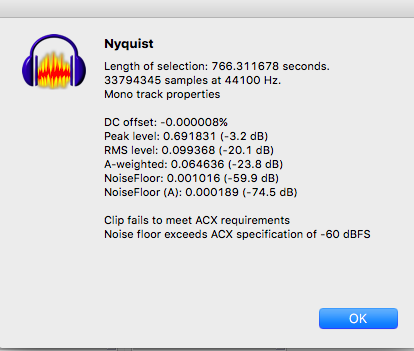

OMG so, freaking close!!! (gouges eyes out)
Okay this was after all the new filters. SO CLOSE
I unchecked the clipping box in amplify, should it be checked?
Amplify, unless you change it, will always try to cram the volume up as far as it can (0). I’m using that predictability to set the parameters for the limiter. The limiter will bring objectionable peaks back down from 0 and leave everything else alone.
The final cleanup in Normalize brings us into (hopefully) ACX compliance.

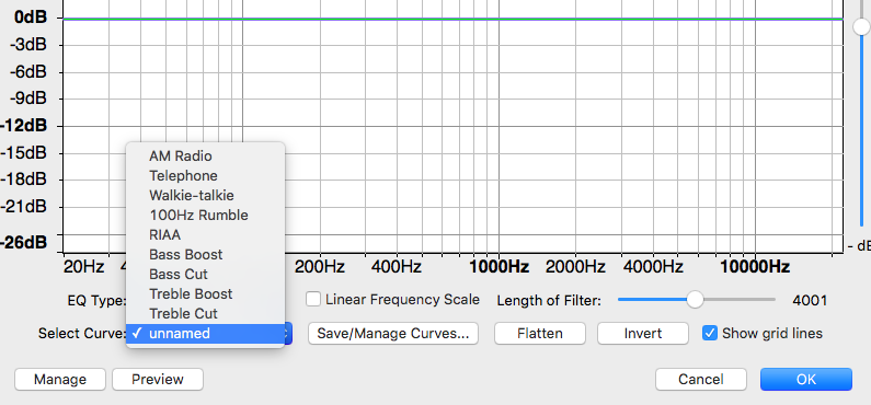

Put something on the timeline so you can see Effect > Equalization > Select Curve. Do you see LF Rolloff For Speech in that list?
Okey dokey, I do not see that from the list :frowning:

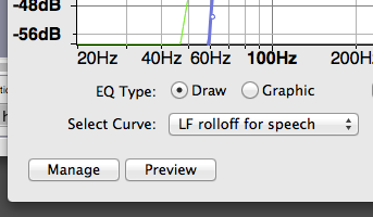

Put the test chapter on the timeline and Effect > Equalization > Load Curve > LF Rolloff…etc, Set the length slider to about 5000. > OK.
It should look a little like the attached (click or scroll around).
I expect little or nothing to happen to the quality of the sound, but a couple of dB worth of rumble (thunder, metrobuses) should vanish making it easier to make ACX Noise. You don’t have to actually have a metrobus. Some microphones make noise down there secure in the knowledge nobody can hear it. But ACX can hear it.
