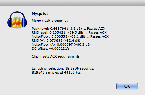

Without directly addressing your problem, there is a new version of ACX-Check which is a little easier to read. It piles the three important values at the top. (illustration attached).
http://wiki.audacityteam.org/wiki/Nyquist_Analyze_Plug-ins#ACX_Check
Thank you for the raw posting. It’s valuable to know the starting point.
Those values are not that far off. When I do testing (such as that illustration), I’m not sure I could keep that up for a book. Some of it is going to fall off the bottom of one or more of the specifications. Note that even though I met them all, it’s not by much.
Before we go too overboard, post a WAV voice test raw. No processing. It’s not unusual for microphone systems to create artificial rumbly “sound” nobody can hear. If your overall noise values are just a bit too loud, eliminating them might get you into compliance. It’s an easy inaudible fix.
