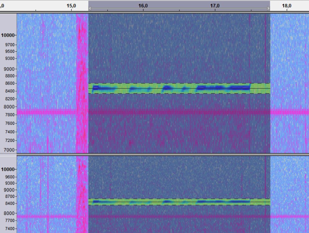

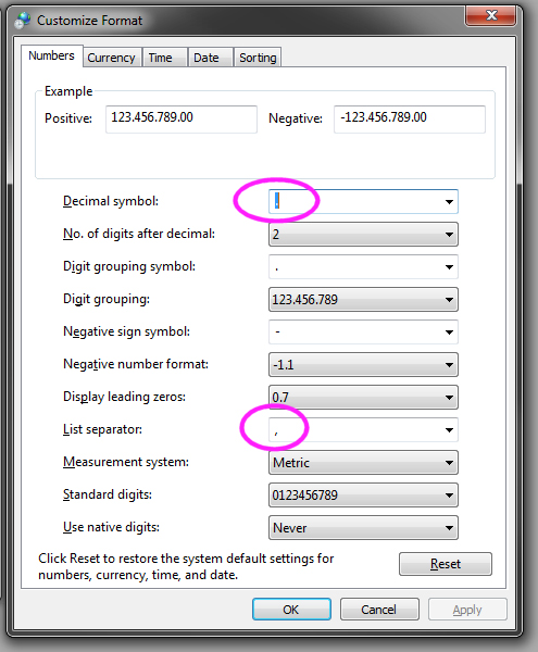

As Trebor indicates, the “Numbers format” should match the language settings so that a dot is used for languages that normally use a dot, and a comma is used for languages that normally use a comma.
I think that indicates a separate problem of Audacity not being installed correctly.
I suggest that you do the following:
  1. Check that the Number format and the System Language setting match. For example, Language = US English and Decimal separator = dot.

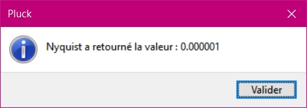

Does “Generate menu > Pluck” work for you?
If I change the decimal symbol from dot to comma,
notch-filter fails either silently, or fails with the error-message is shown, (on Audacity 2.3.2)
Revert back to dot then notch-filter works normally.
Well Trebor, you got me with that ! The moral of the story is… the nyquist filters are ill written : they should always accept both the comma and the period as decimal symbols. To whom it may concern, take heed of that and correct your plugins !

don’t know how to use the Pluck thing. What I did is create a new track (mono). positioned the marker at some arbitrary place and generated the nyquist Pluck thing keeping all the Pluck default setting as is. Nothing happened besides the generation of this window:

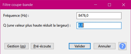

The input box of ‘frequency’ is :
where the ‘frequency’ input field is the top one, obviously, and does a first validation act live as the user types in his figure. If the user type a decimal not corresponding to the one defined in the system, it is NOT accepted and, if none is typed, one is added by default. First step.
Second step; when the user click ‘Validate’, then a second set of validation procedures come into play in order for the variable be correctly treated by the remaining code. The validation code VP up above must be the first validation procedure performed in this regard… I presume/assume (!).
I note that in this VP, ‘frequency’ is compared with “0.1” where the decimal symbol is a period. I wonder if this can be a concern and cause a problem here and in the remaining of the nyquist code ? I am not quite sure for in my case, the ‘frequency’ variable is corrected with the comma as decimal symbol (DS) (despite my OS DS being configured as a period) and doesn’t seams to cause any problem in this VP so it appears so… if no problem “seams” to happen here for no error window pops, why should I worry for a problem in the remainder of the code ? No error window popping up does not mean no error happened in the comparison code, and I can’t see where there could be one…
