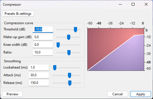

No wonder I couldn’t understand the terms in the afore-mentioned screenshot of the option window!

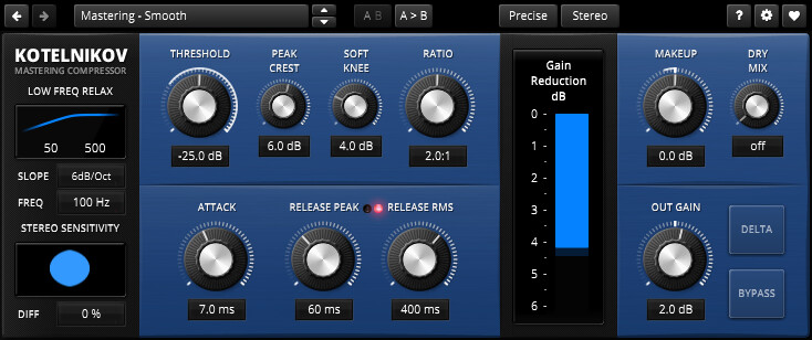

The order in which equalization and dynamic-range-compression are applied makes a difference to the final result: they are not commutative.
Advanced compressors have the option to reduce the bass in the signal used to control the compressor, in this one it’s called “LOW FREQ RELAX”.

The graph shows you what it’s doing except the axes are not labeled (X is input dB and Y is output dB). And it’s only 2-dimensional so it doesn’t tell you any thing about attack and release.
My quick description of dynamic compression:
Compression reduces the dynamic range (or “dynamic contrast”) by making loud parts quieter and/or quiet parts louder. In practice, usually it “pushes down” the loud parts and then make-up gain is used to bring-up the overall volume, making everything louder.
Limiting is a fast-kind of compression. Clipping is a BAD kind of limiting.
Automatic gain control, automatic volume control, or leveling are a slow-kind of compression.
