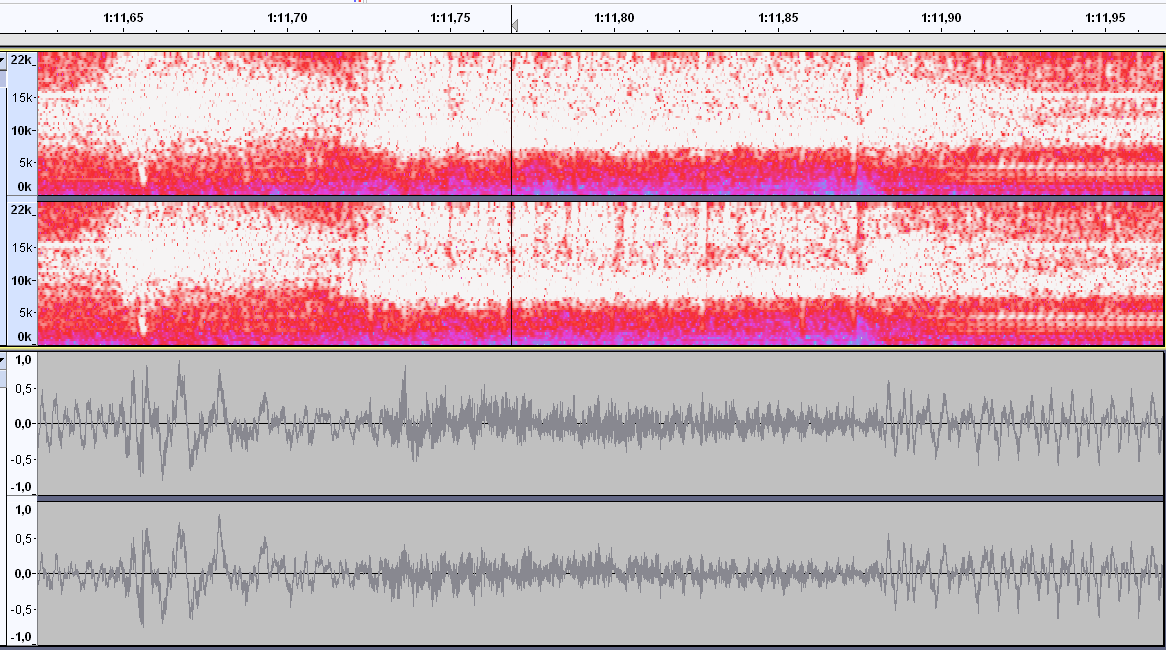

For example, on this screenshot of the wave form, there are 2 cracks… But I can’t locate them…
Try the [u]spectrogram View or Multi-view[/u].
I tried but I see nothing :-/
I actually don’t understand this view.
Edit: I can see a few lines that may match with the cracks. It helps a bit. Thanks.

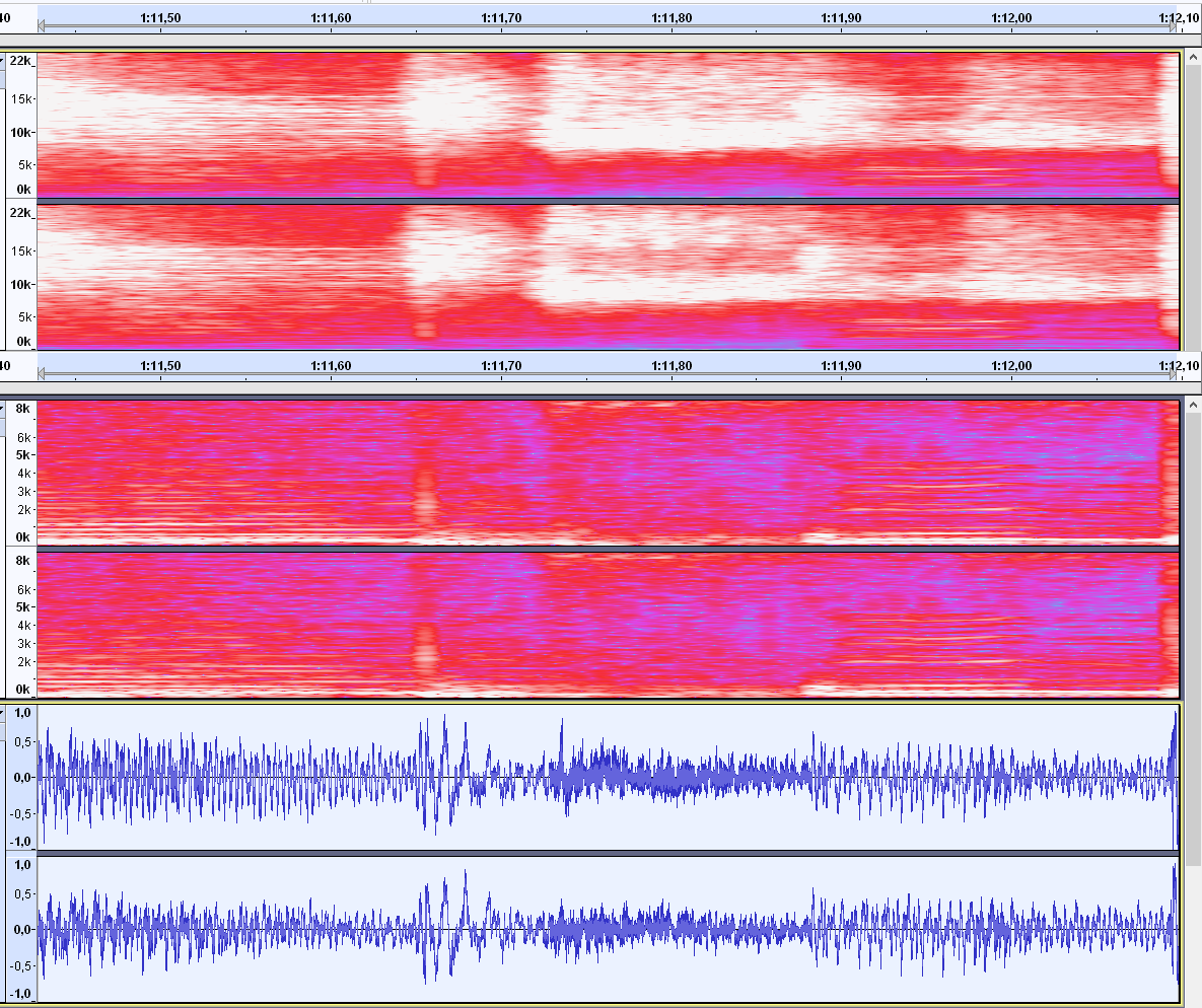

Try spectrogram view
Audacity’s spectral editing tools can cause less collateral-damage than repair tool.

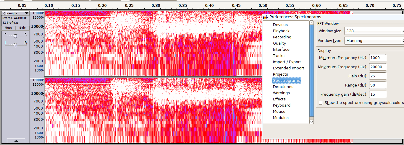

Here is the sample with a screenshot of the graphic with 2 different spectogram view settings.
So, if anybody can help with that, it’s welcome.
Reduce the spectrogram FFT window-size to 128 to see clicks.
The clicks will be easier to see if you apply this sort of equalization first to “sample.flac (146.6 KiB)” …
Thank you. I did what you suggested but it didn’t work.
Here is the graphic at 128. The equalization you suggested didn’t remove the clics/cracks/parasites :-/
