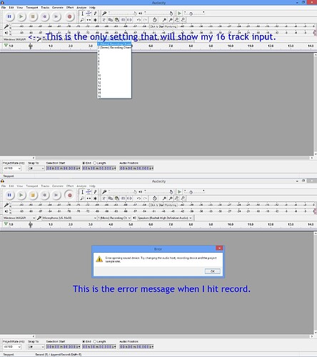

I was refereeing the OPs request to record with several inputs at the same time. “I don’t know how to make audacity record from multiple audio devices simultaneously”. I am running the latest version and it will not work for me as you say. I did follow the link and I am sure I am choosing the correct inputs. I took a pic and maybe you can point me in the right direction. It does the same thing regardless of what track I choose, or record in mono or stereo. I had this same problem with my Alesis Multi 8 track fx usb interface. I can run eight channels in at once, pan 4 l and 4 r but that defeats the purpose for what I was trying to do. Any suggestions would be most welcomed. I think I have also recreated a problem over in the Teaching forum. I will recheck the post then post my pic as well.

When WASAPI is selected as the “host” in the device toolbar, applications connect tightly to the device drivers. This usually has benefits of low latency (not important for Audacity), and for multi-channel sound cards it often allows multi-channel recording without the need for ASIO (which can be useful for Audacity as ASIO is not open source and cannot be distributed with Audacity). The downside is that options are limited to the capabilities of the hardware and its drivers, which in practical terms means that it can be very fussy about sample rates, the number of channels and exclusive access.
When MME (or Direct Sound) is selected, Windows takes over the sound system and can usually provide a lot of flexibility over sample rate and shared access, but is usually limited to a maximum of 2 channels (mono or stereo).
According to the “Audio device info” that you posted, it should be possible to record from the Tascam using MME, but with a maximum of 2 channels. Usually the available channels are the first two channels of the device. (Input 1 for mono, inputs 1 and 2 for stereo).

I couldn’t find that Audio Device Info, but if you wanted to use WASAPI host you might have to record all 16 channels and close the tracks you don’t want after recording.
