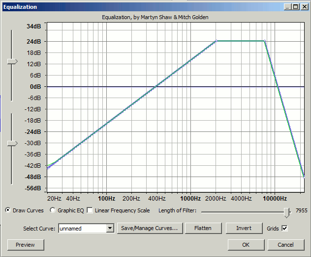

Try this equalization

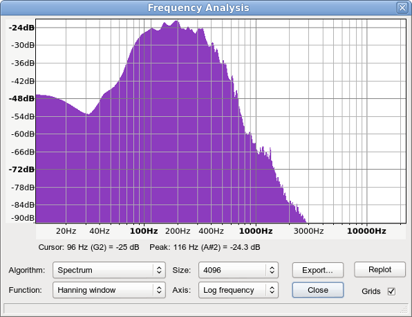

The problem can be clearly seen in the spectrum
Nearly all if the sound energy is below 800 Hz and there is very little sound above about 1000 Hz. It is the frequencies between about 1000 and 7000 Hz that makes voices bright and clear but they are almost completely missing. The recording is so bad that only a limited amount of improvement can be made by using extreme Equalization changes.
The attached XML file can be imported into the Equalization effect (as described here: http://manual.audacityteam.org/o/man/equalization.html#manage) to provide a curve similar to that described by Trebor. The new curve is called “de-muffle”.
de-muffle.xml (611 Bytes)
Thanks a lot. Now it’s possible to hear what he’s saying. Pitty that there is a scratch or what is is, every time he starts talking, but I guess I cannot have it all :slight_smile:
