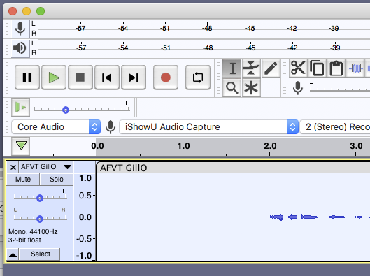

I took some of that out as a test.
Sorry. Missed one. Your recorded volume is low.
How you did it (blue waves lower right).

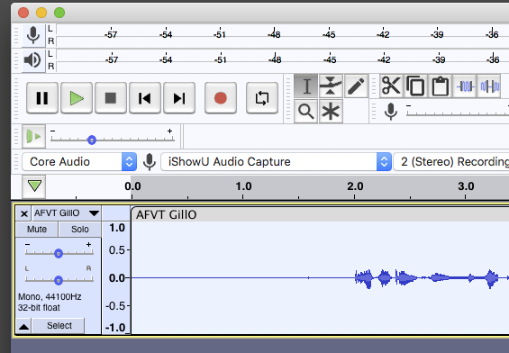

About here would be minimum volume.
And even louder would be OK.
To get to that last one, I doubled your recorded volume…twice. That might be rough for a home microphone to do and we can use what you have. It just takes some serious volume boost to get to ACX acceptance. I only bring it up because low recording volume can produce background noise problems.

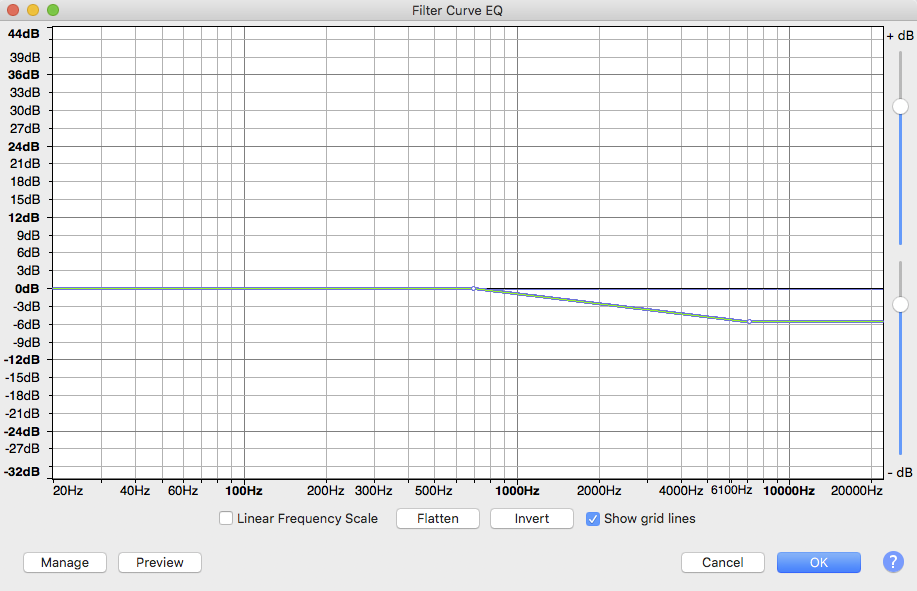

This is Effect > Filter Curve EQ.
Louder is up, quiet is down. Pitch is left to right. Earthquakes and large trucks on the left, sizzling, frying bacon on the right.
On the left: 0dB is no change. -6dB is a reduction to half.
On the bottom, the correction starts at 700Hz and gets stiffer as it goes toward the right. It stops changing at 7000Hz.
The area of the slanted line and to the right is where your crisp, gritty sound is. Fair warning, if you change microphones, it’s a good chance you’ll have to find a new adjustment. That correction isn’t a gift from the angels, either. That was just first pass based on a quick analysis of where the harsh sound is.
When I get back, I’ll see if I can generate a more complex curve that’s doesn’t sound quite so muffled. Yes, there are automatic tools that can do this—De-Essers—but you have to critically adjust and set them up similar to the De-Clickers. Wasn’t that fun?
