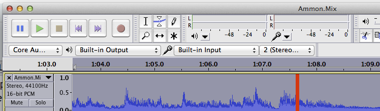

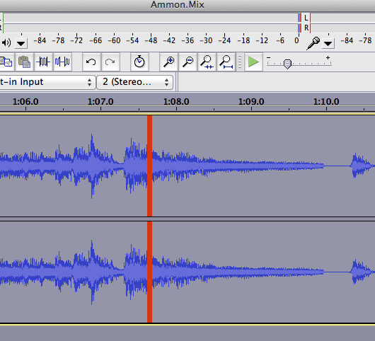

Thank you for your test clips. This is from from first clip. I did see something that went by you. Attach #1 is a blast of odd sound just past 1:07. Attach 2 is the same segment where I told Audacity to show me serious overload (in red).
So something at that instant made the digital sound channel completely overload. I’m guessin’ that wasn’t you playing.
This is messy. I’ve never heard of anybody with that kind of distortion.

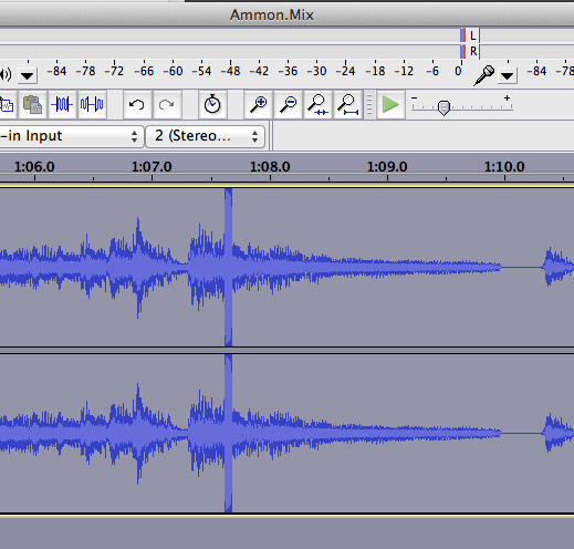

The third attach is what my Audacity looks like at the top. Can you do a screen capture of yours and post that either on the forum or somewhere.
https://forum.audacityteam.org/t/how-to-attach-files-to-forum-posts/24026/1
