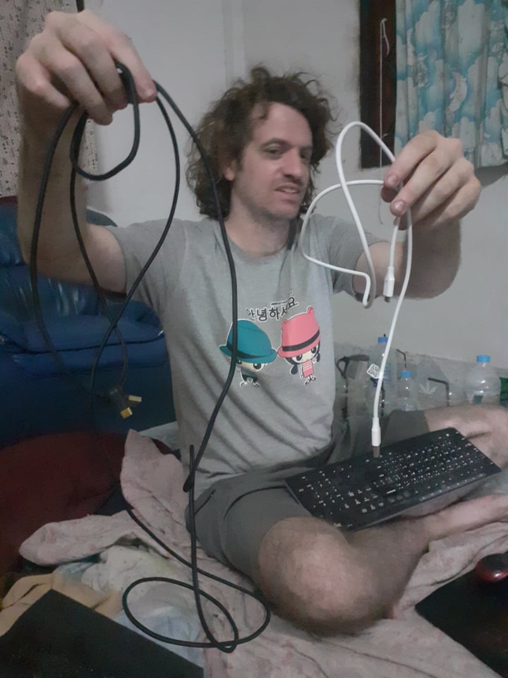

My GF is to blame for the last house fail, the USB Cable is only $6 so when you put one end below the mic you need to give one last push to go deep enough. Now everything works fine!
Another thing is at the shop we also tried a USB 3.0 (Hub) + USB Charger plug to the wall, as you mention and it was even better than just with the shorter cable. The shorter cable is solving the static problem on his own but adding a USB Plug with the charger increase the overall sound quality, so I might go buy it tomorrow.
Below is a picture of the longer cable (the black one that came with the Mic), and the shorter white $6 cable that solved the static issue. I also did a short recording with the same short cable with gain high-middle-low, keep in mind that the fan was close to me and the cricket outside were loud. I’m okay with that, I have a good room to record without all the noise, I was just testing.
