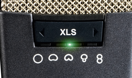

We need a mic that can project both my voice and GF voice
That’s a problem. Are you two going to speak on the front and the back of the microphone? You will need a microphone with either a figure of eight pattern or omni-directional—record from all over. Both of those need good sound proofing in the recording space and not just an empty room.
This microphone can switch between all the common patterns.
Omnidirectional. Record from all over.
“Soft” cardioid. record mostly from the front half
Full Cardioid. no recording from the back.
Hyper Cardioid. ignore sound from the back and sides.
Figure of Eight. Record from the front and back but not the sides.

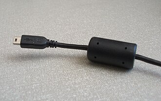

It may be worth trying a better quality USB lead if you have one. Some USB leads have one or two “ferrite beads” which can help to reduce the noise from USB power.
Can buy clip-on ferrite-cores ~USD$5 for a pack of 10 …
So can add on multiple cores if necessary, (on the computer power cable too).
